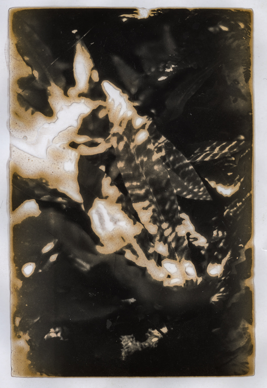

This all piqued my interest and I did a few searches for other APUG threads on the subject, and there are quite a few. A couple mentioned a test IPI developed that involved exposing a print to Hydrogen peroxide fumes, and being of the "I wonder what would happen if ..." persuasion, found a (very) scrap print on RC and taped it over a tray in which I had laid a sheet of paper moistened with 6% peroxide. I left it, wrapped in a plastic bag, for a few days, and this is what came out of the bag today.
Please note that this is not intended as any sort of controlled test, plus the print was probably neither fixed not washed properly, so no conclusions are being drawn! But I thought it might interest one or two of the contributors.

Without knowing the original image, that effect does look quite similar. And that's as you would expect: it seems that this effect is due to oxidation of silver freeing up Ag+ ions to migrate through the emulsion. Once freed, they either get reduced by some sulfide in the air (producing the bronze look) or they make it to the surface of the emulsion and reduce to metallic silver (producing the mirror look).
Any oxidising agent should be capable of liberating Ag+ ions, and peroxide certainly is a good oxidiser! I suspect that H2O2 fumes might also cause rapid damage to FB prints - any unprotected (no toning, no sistan) silver print in an oxidising environment like that is going to suffer badly. You can see plenty of degraded FB prints that have silvered out, the conservators believe due to exposure to oxisiders including high moisture content in the air.
The supposition behind what I've been reading (and have heard back from the conservators that I emailed) is that RC prints are unusually vulnerable because the TiO2 brightener can act as an oxidiser when exposed to light, as can (perhaps) fumes released from the coatings on the paper. So while a framed FB print will be in a nice clean environment, an RC print itself produces one or two different oxidisers that can liberate silver ions for migration, and that can start occurring within a few months if the print is behind glass, trapping the fumes. I suspect that manufacturers like Ilford have perhaps solved this problem with their papers, as the recent (2005+) reports seem to concern only Foma RC papers and, anecdotally, all my Ilford & Kentmere prints are fine.
