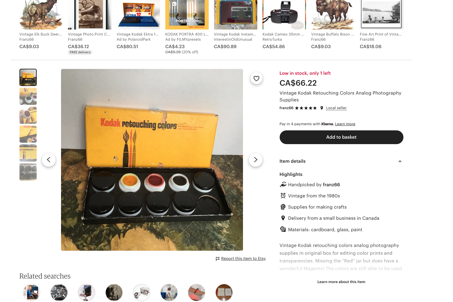

I just purchased this kit thanks to this thread, I used these extensively back in the late 70's to bring down tones, apply with a soft cloth, air breath on the cake put on a bit on cloth and apply, when finished steam the print and the dye goes into the print and there is no evidence.
