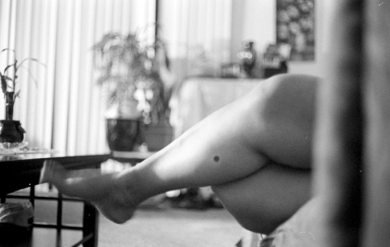

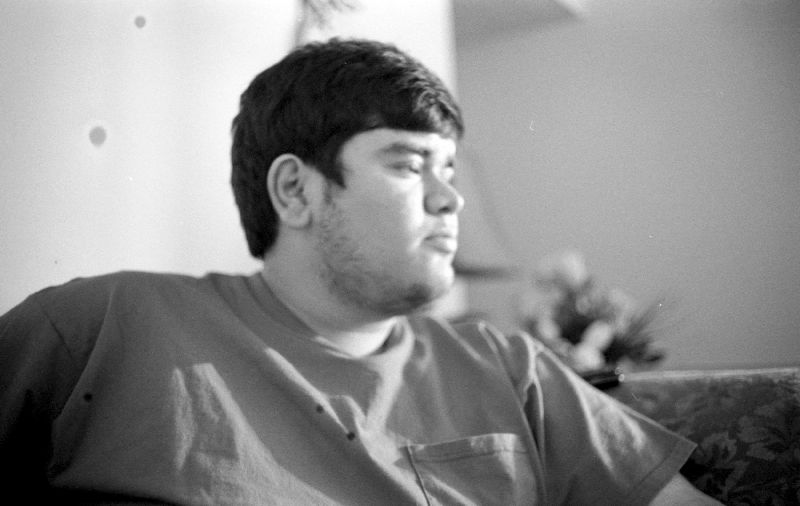

I scanned 2 rolls of film that I developed last night. It was a Kodak Tri-X and Ilford Delta 400, both are about a year past expiration date, but are cold stored since I had them. What I did was I developed them in stock Xtol for about 7 minutes and 10 seconds agitation every minute. After developing I washed them with water for about a minute, I did not use the stop bath that I have since in my previous sessions all I developed without it came out fine. Then Kodak fixer for ten minutes, after that I washed it again for 10 minutes and applied Photo Flo last. Only the Tri-X showed these spots. what could it be?

They look like bubbles on your film when you developed them. You need to tap your tank to dislodge bubbles when you pour in the developer. I could be wrong, but other APUGers can correct me if I'm wrong.
They look like air bubbles to me. Presoaking the film before development will help eliminate this problem as will tapping the edge of the tank as you pour the developer or prewet water into it..
PE
I agree. Soaking the film with tempered water for a minute before the developing step and rapping the tank after each agitation should prevent the problem.
I see. Will inverting the tank do the trick? In my past developing sessions I invert the quickly for like 10 seconds, but last night I just swirled it around.
Sometimes in hard water areas air bubbles can be a real problem, they can occur at all stages and tapping and slightly more vigourous agitation may help, as may a pre-soak. However sometimes they can't be eliminated easily, it may be you need to use deionised/distilled water to make up your chemistry.
Developers are designed to cope with most tap water but there can still be problems. I did some visual testing 2 or 3 years ago and found that air bubbles can form at any time and they mainly stick at the edges, good agitation removes some but in my case (very hard & slightly salty water) a pre soak, tapping, inversion agitation wouldn't stop them. Some emulsions are more prone than others as well.
However as yours seem to be in the middle of the negatives your initial agitation is probably insufficient it should be continuous for at least the first 30 seconds.
You posted as I was writing and effectively confirmed my above comment :D
