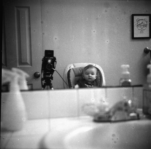

I'm getting some spots occasionally, but they're not exactly like the OPs.
Can someone identify these?
This is Xtol that has been mixed for over a month, stored in a cool dark place, mixed only with distilled water. I do rap the tank, but I stopped pre-soaking after all my research led to the general conclusion that it wasn't necessary.
I do not shake or stir the Xtol before mixing it 1:1 with distilled water. Should I be doing that?
When these marks do happen, they seem to be on the last two or three frames only, but that could be coincidental.
Looks like air bubbles or foam. Can you see any foam on the top of the solution? What kind of film is it?
PE
This was Arista EDU 200. But it has also happened with an expired roll of Shanghai 100.
I never noticed any foam.
I do also develop color film with a Unicolor kit, but in the case of the Shanghai film, I developed several rolls of black and white between the CN and the Shanghai with no issue, so I don't think it's a matter of left over/dried on stabilizer.
If they run lengthwise to the film, I would then suspect a coating defect, but otherwise I would still suspect some sort of bubble effect.
