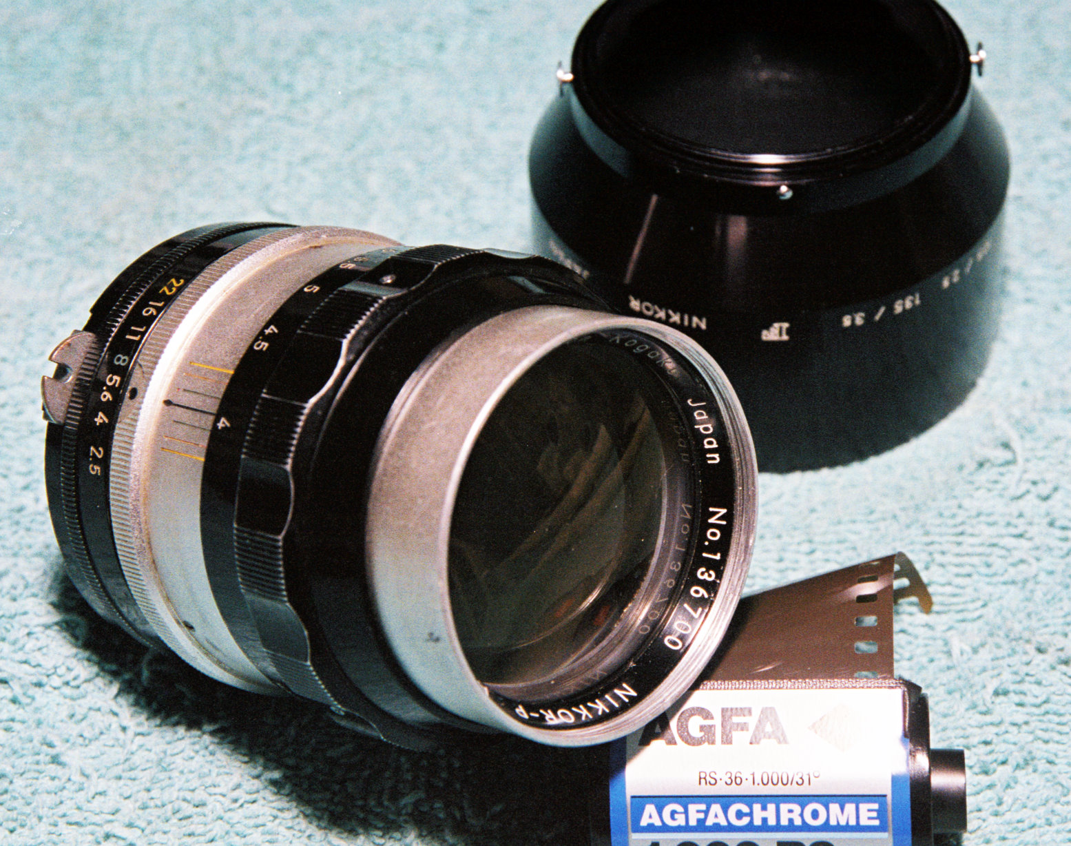

I mainly like the older lenses for their cosmetics, chrome trim and all-metal construction. Perfect with a Nikon F, F2 or Nikkormat body. Plus they are generally cheaper. Some of the older lenses had different optical designs than the later AI & AIS versions, and may give a different look. I have an early Nikkor-P 105/2.5 which is a Sonnar design, and a later AIS 105/2.5 that is a Gauss design and is very sharp. The older lens is not as sharp, but I actually prefer it for portraits.Coatings on the old lenses were not as good, but I always use lens hoods and haven't had much problem with flare. Here's two sites that compare the old/new versions of Nikkors - from Bjorn Rorslett and David Ruether.

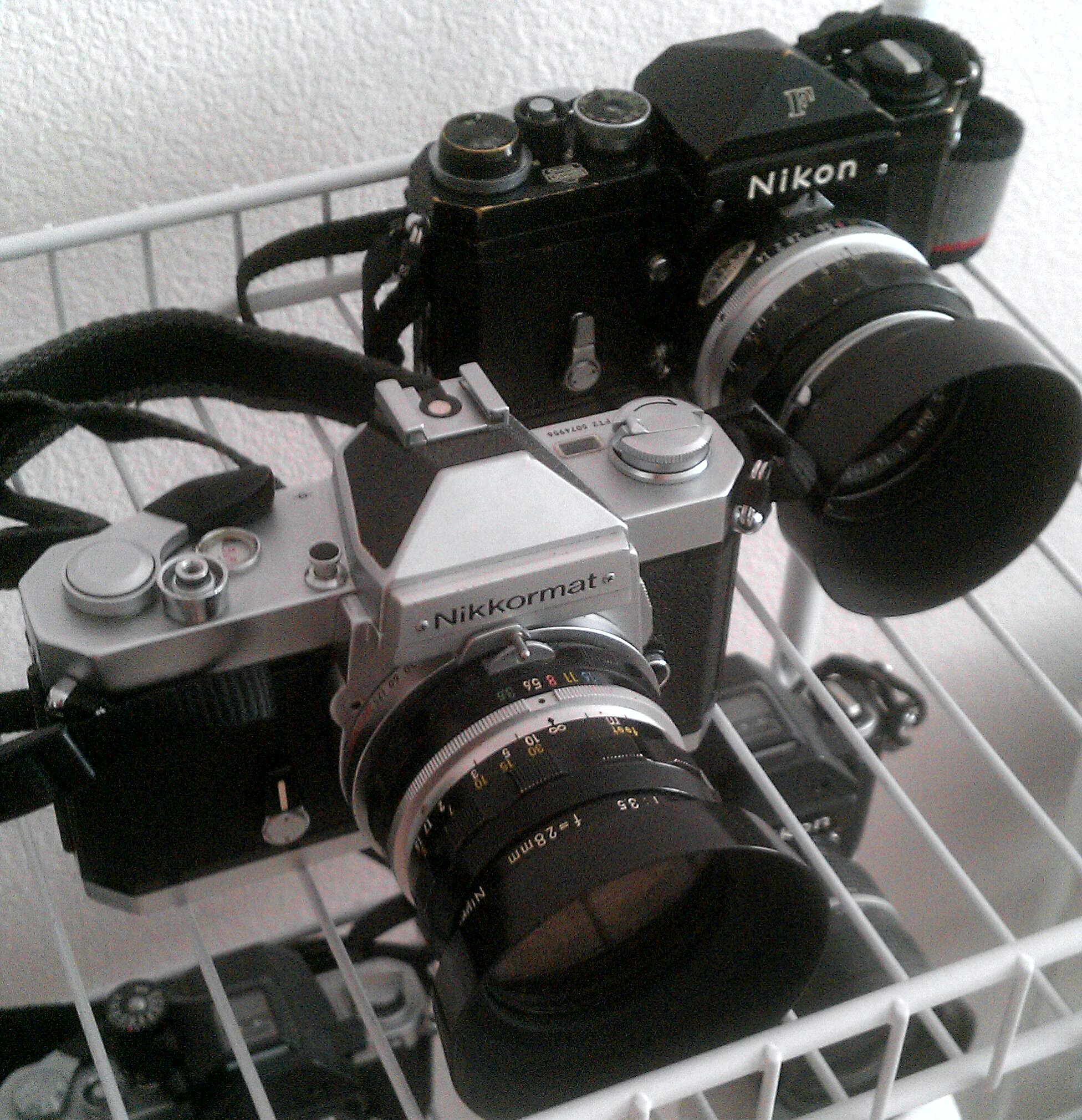

I’d never part with this gem.
