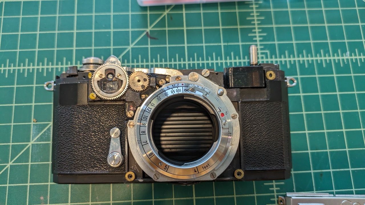

Recently I got a IIIa with a mostly working shutter except /1250s but too much dust, grime and haze in the viewfinder. I did open up the top and front cover to clean up. If you buy a $1 repair PDF manual from the learncamerarepair store, you should be able to do something similar without too much sweat. In the end, I did not touch the shutter nor adjust the RF.

I have taken apart both the Contax II and a 1950's Kiev 2a.
The insides of the Kiev were almost identical to the Contax ... which is not unexpected. There where some minor material changes.
