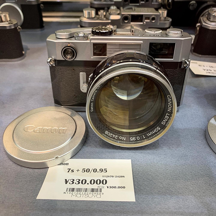

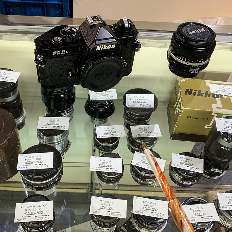

A few photos from the fair (which goes all week): inspecting the soon-to-be-mine FM3a and 50mm on top of one of many Nikon cases, the 0.95 Canon lens (this was the cheapest one I found), and the last is what a lot of the camera cases looked like when they opened at 11, by the time I left around 2 p.m. many were half empty. A lot of people came here with suitcases (!) to fill up with gear - the Leica sections were always the most popular, but there was a nice selection of cameras from a variety of manufacturers (Alpa, Argus, Canon, Contax, Exakta, Kodak (stereo only), Leica, Nikon, Rollei, etc) in really beautiful condition, from mini micro cameras you could fit in the palm of your hand all the way up to large format (film holders too - very cheaply available in 4x5, 5x7, and 8x10). What was I saying again? Oh yeah, iconic Nikon lenses. I'll be watching this thread and/or referencing when I go back to the fair tomorrow or maybe every day this week. :wink:
