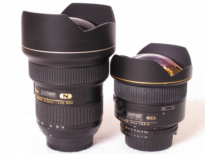

The 35mm was my first 35mm SLR wide-angle lens and my first 35mm rangefinder wide-angle lens..
Later, the 20mm became my widest. However, I traded the 20 for a wider 18.
Today, the 14mm f/2.8 is my widest. Hopefully, it will become a legendary lens.
Nikon Wide-Angles by Narsuitus, on Flickr
Very nice lens combo for sure. Curious which you use, when & why?
I need wide angle-of-views for shooting vehicle interiors, architectural interiors, scenics, and cropped panoromics.
In my film only days, I was primarily a manual focus prime lens shooter. When auto focus and digital became popular, instead of replacing my manual focus primes, I decided to start using auto focus zoom lenses with my primes. At the time, 18mm was my widest prime. My 18mm gave me a 90 degree horizontal angle-of-view on a 35mm cameras.
I purchased the 20-35mm f/2.8, 35-70mm f/2.8, and 80-200mm f/2.8 auto focus Nikkor zoom lenses.
The 20mm focal length was wide enough on my full-frame bodies; however, it was not wide enough on my APS-C digital bodies. Therefore, I purchased the 14-24mm f/2.8 Nikkor zoom. The 14mm focal length gave me a slight wider angle-of-view on my APS-C digital bodies than the 20mm focal length.
However, the 14-24 was a G lens with no aperture ring and therefore did not work well on my Nikon F2 film bodies which needed lenses with an aperture ring. Therefore, I purchased the Nikon 14mm f/2.8 D lens which has an aperture ring.
My 14mm focal length gives me a 104 degree horizontal angle-of-view on a 35mm cameras. Therefore, I tend to use the 14mm f/2.8 prime lens more on my Nikon F2 bodies and on my Leica rangefinder bodies (with a Nikon F to Leica M adapter).
