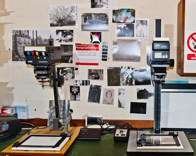

Honestly can't remember the make of the enlarger, but see the pic below. I can't make out all the writing, but someone might recognise it? It the one on the right, obviously....

Here is KHB's information page for that enlarger: http://www.khbphotografix.com/LPL/LPL6600Cond.htm. That page indicates that there is a filter drawer in the condenser head.
You could also use the colour filtration in the other enlarger to adjust contrast for black and white work.

I would like to use the colour one, mainly so i could do colour prints (not yet though!) but upon fiddling around i discovered the control box for it has literally been cut off and is missing! The pic is old of their website...

It does have a little drawer at the top with a glass plate and a lens in, i did wonder if that was where a filter would go, but it also got pretty warm in there after being on for a while focusing and lining the image up. Was slightly worried the filter would melt....
That is probably the condensor lens which adapts the light head for a particular film format, and not a drawer for filters. Filter drawers are meant to be slid out rather simply, while condensor assemblies ordinarily require some modest 'dissassembly' of the head. Ordinarily filter drawers are a metal frame for filters with no optics. But one possibility is that there is a UV filter or heat absorbing filter.
It looks like it has a little filter holder under the lens. Does it?
