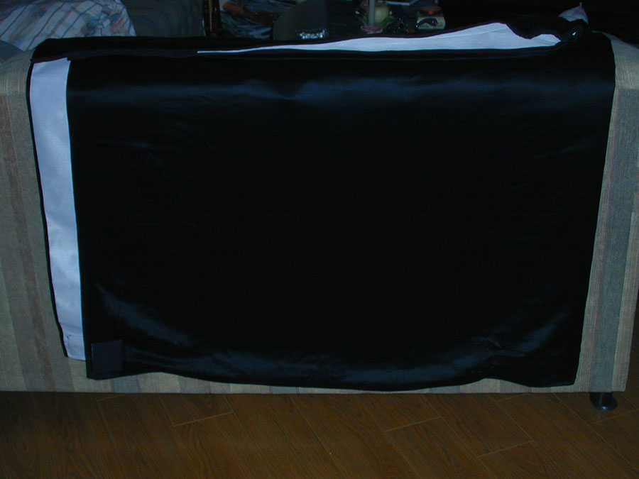

This is a dark cloth the little woman made for me. This is made with a light weight gortex material. It is white on one side and black on the other. She then lined it with black china silk. It is around the 14x14 tailboard wet-plate camera in the photo. I'm still not sure about the black china silk it is quite slippery. When she asked how I liked it the first time I used it, I replied..."well its kind of like wearing your panties on my head dear." It actually works very well and it has already saved the camera from a rain storm...very waterproof. It fits my 8x20 and 12x20 film cameras and just by chance it fit the 14x14 tailboard as well. She added elastic at the top with velcro closures at the bottom and a couple of pockets that weights can be put in at the bottom on windy days. Actually it is a little off white more like a very light gray.

RobertP

" What light through yonder window breaks. It is the east and Juliet is the sun. Cast off fair sun and kill thy envious moon. For she is far far more fair than thee"..........

So robert you like to wear panties on your head huh? :D
That's a nice looking darkcloth. I plan to have the porter's stuff inside and the white ripstop on the outside bordered with some grosgrain or bias tape. I'm not sure how I'm going to do attachment yet. I had the BTZS tube for my 4X5 and 8X10 before they got sold off... I might do the elastic, but I might explore string and a toggle or perhaps shock cord and a toggle.

Scott, Yes it is a Star N E Plus. It does have a rise and fall front standard. But other than that no other movements. It is basically a replica of an old tailboard. And I've kinda gotten away from wearing her panties on my head over the years. Especially now since they are no longer silk but flannel.

If anyone is interested the Gortex is a thin 2-ply. White and black. I think she got it from a place in Colorado called Rockymountain fabrics or something like that. I'll ask her the details. But if I recall she said she had about 60.00 in materials in the whole thing. Now according to her that is about 1060.00 if she had charged me for her time. The nice thing about it is it weighs about 1/3 of the weight as my old horse blanket and its much cooler in the summer and extremely waterproof.
