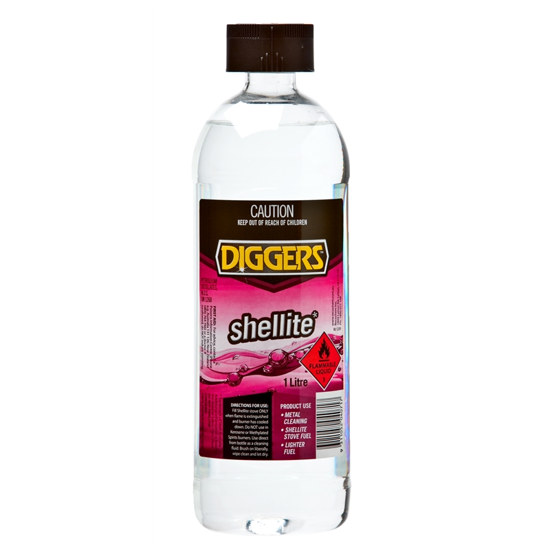

Diggers Shellite is identical to Kami fluid, and cost a whole heap less, and you can buy it at the hardware store. Totally inert for film and evaporates with no residue. Been using it for years, after the performance to get Kami, which most people won't ship due to its volatile nature. Last lot I had to get sent sea freight.
As best I can find, Diggers Shellite is mostly Acetone. Kami is a hydrocarbon. I guess I know why Kodak used the silicone fluid. It is not flammable and has limited volatility.
PE
Diggers Shellite is most definitely not acetone!!!!! According to the text on the side of the bottle sitting on my shelf, It is a 100% hydrocarbon.
The simplest test is to smell it. Shellite and Kami are identical in odour, I have both, and they are functionally interchangeable.
You are correct. The last time I searched, I found a reference to Acetone and now it is gone. In any event, both Kami and Shellite are hazardous materials that are seriously flammable, so be careful.
PE
Thanks, I think I'll be right after doing it for nearly 30 years.
The big advantage is really the zero clean up. Just wave it back and forward's until the neg/trans is dry and put it back in its sleeve.
