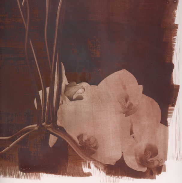

No, it doesn't really look like any solarization or Sabattier as I know it. I have now included a scan below.
Please note it looks horrible, but it was in the toning solution way to long, so there is an overall dense red cast.
Notice the "peeled" of paint look to the left of the metal candle and orchid flowers... The lighter areas are where the black resistant (copper?) deposit was. So you will just have to imagine that. Replace the lighter areas with black, and that was what I saw after about 10 min up to about 1 hour. After 5 hours bleaching and toning, this was left...
As said before, these were the areas of highest silver density and thickest emulsion, almost completely black in the original print before toning.
Tim: I still think though that your's and PE's suggestion of the formation of light sensitive and possibly metallic copper is on the right track. The "resistant" black stains just can not have been silver, considering the completely different response to the bleach in the solution and the fact that no toning took place in these spots.
Hmm, I've never toned a print in copper for 5 hours so can't speak from personal experience! However, the result doesn't look too surprising considering the natural tendency that Cu has for solarisation and tone reversal and the grossly overtoned treatment. What would be helpful/interesting would be a see scans of the untoned print and a normally Cu toned print (say a few minutes!) side by side.
BTW, what was the paper and developer?
Tim

Tim and PE,
Thanks for all the input so far.
Tim: I am not so much interested in the "overall" look of the scan. Do you understand which areas I mean? I maybe should have marked them, but they are visible enough. I am talking about the large lighter red coloured areas left of the metal candle-standard, you can also see some of the "peeled-of" areas in between the candle-standard legs and two areas above the orchid flowers. The edges are ragged while showing the direction of the brush marks of the liquid emulsion coating.
These "lighter" areas remained almost completely black after the rest of the print had toned and switched to red, they clearly resisted bleaching. I still think it might have been some kind of copper substance, maybe caused by an initial very high silver content in these areas, as it responded completely different than silver.
About the paper and developer:
I used an art paper specially designed for acrylic paint. I have good experiences with that in combination with liquid emulsion. The paper is though and durable, and thus withstands the wet processing well. It has less tendency to buckle than watercolour paper in my experience. I think the main difference with watercolour paper is that it is quite heavily sized, so as to absorb less water from the acrylic paint, contrary to watercolour paper if I am right.
The developer was just an ordinary developer similar to Ilford Multigrade developer.
Here's an example of how the print looked, notice that there are no lighter areas in the print left of the candle-standard foot (please note, this is another liquid emulsion print of the same negative on a smaller size, so it's not the same as the one I toned!, but it does give a good impression):

Well, FWIW, I have had the same effect take place with copper toners, and it does appear in high density areas and appears to be a complex redox reaction with copper, silver and the other ingredients.
Also, FWIW, the effect appears to vanish or become very minor with lower silver papers. And, it can be taken advantage of for some very nice effects as it varies from paper to paper.
PE

Thanks Marco. That original scan makes it much easier to appreciate your description. I agree with PE, this sort of effect is not uncommon with copper toners, particlarly with high silver emulsions and or cadmium containing emulsions (only one left now). You could try putting it back in developer and reverting to B&W. You could then tone it more subtly, but redeveloped prints often solarise quicker - but you might like it.

Thanks Tim and PE. I think you both explained it well enough. I don't need an exact explanation, I was just very curious as what was going on.
It's good to know these things can happen, especially with copper toners.
Revert back to BW :confused: You mean the silver is still present? I thought the bleaching and toning would somehow remove the silver from the print with this kind of toning... according to your reaction it isn't... Well, time to look up the chemistry behind this kind of copper toning, do you have an internet reference for that? The reason why I originally thought the silver would be removed (contrary to with for example a sepia toner where the silver is converted to Ag2S) is that the red coloured substance that makes up the tone, is formed as a visible suspension as soon as you add the components of the toner together, even without the print being present in the toning solution. So contrary to a sepia or selenium toner that directly converts the silver and causes the colour change to brown, the red is formed by the copper itself, and not necessarily as a reactionproduct with silver, and than somehow deposited on the image???
Well, OK, so I have given a try to redevelop it, and yes, it does turn black, but as expected the areas that caused an issue with the copper toning, don't completely turn back to deep black, they stay just as visible as in the red toned print. Of course this is no surprise, since something went wrong...
