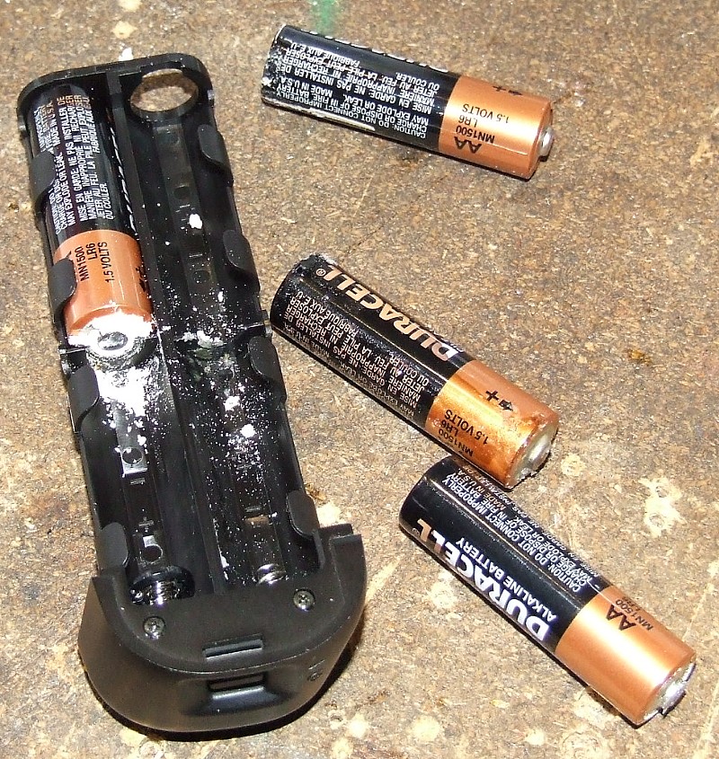

My experience is that alkaline cells made in the last 10 or 5 years tend to leak a lot more than cells made before that. Before an alkaline cell would leak because the device it was in drawing some current and completely depleted it. Now I have seen alkaline cells of all kinds and brands (Duracell, Enegizer, RayOVac you name it) from AA/AAA or button cells leak even when they are in their own bubble pack and a years before the expiration date and still have plenty of energy left in them.
I think the modern alkaline AA and AAA batteries have increased capacity, but that is accompanied by an increased likelihood of leaking.
