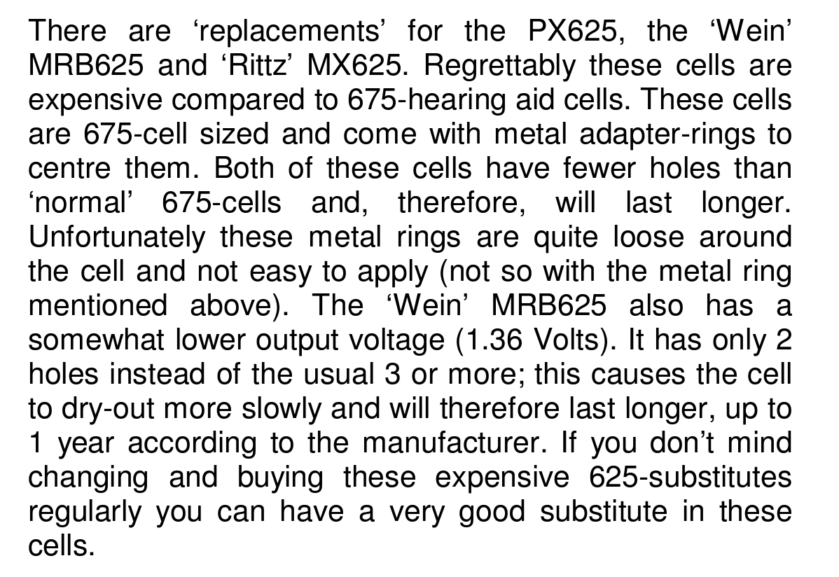

I've been looking at that option—even went to Addison in Montreal to see if I could find one but they never heard of it 🤨—, but was weary about the cheap imitations. Thanks for the link. They also give info on the Wein cell:
"Another PX625 replacement is a zinc air battery. The WeinCELL MRB625 is a custom zinc/air battery designed to replace banned mercury batteries. WeinCELLs deliver the same 1.35 V voltage and stability of output as did the mercury PX625 batteries so there is no need to adjust your exposure. The WeinCELL MRB625 batteries last much longer than hearing aid batteries, some times up to a year. To achieve this longer life, the MRB625 used a proprietary electrolyte and has only two small air holes, instead of the 7 larger holes found in standard hearing aid batteries."

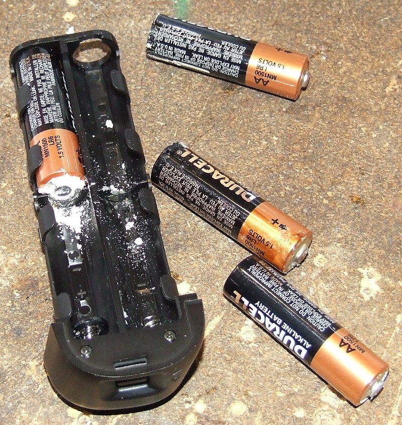

Probably less a problem with silver-oxides, but alkaline batteries leak in some devices fast, so I remove batteries as well if I don't use the thing for a while...

, but this seems unduly fastidious.
Referring to removal of batteries? Removing batteries from photography equipment is pretty much a universal standard. Not only does every user's manual recommend it, if one does any camera repair work at all, one would know corroded batteries are a frustrating and preventable complication.
