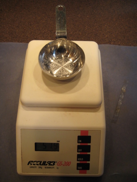

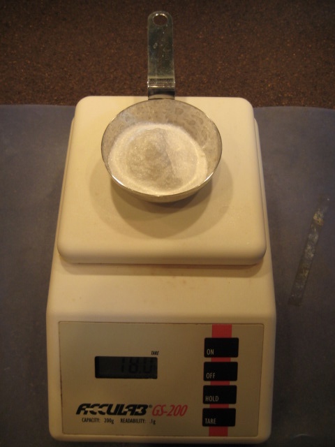

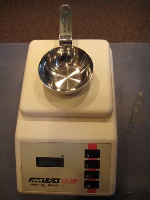

When mixing a developer that uses hydroquinone I have noticed that after weighing and pouring the HQ into the developer solution there is always some HQ clinging to the sides and bottom of the weighing vessel. So today I weighed that vessel (51.8 grams), added the HQ to the vessel (in this case, 18 grams) then added the HQ to the developer solution. I then reweighed the vessel which contained HQ residue. [See photos. They are stitched together. Proceed from top to bottom.] Sure enough, the weighing vessel now weighed 51.9 grams. So from now on I’ll try to remember to add an extra tenth of a gram of HQ when mixing that particular developer.
