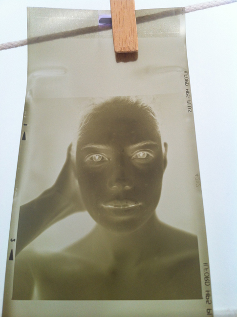

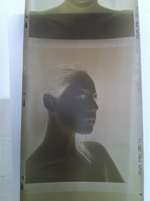

No scanner, but here are some snaps from my iPhone!You can see patterns where the film was in contact at the head of the reel as well..
