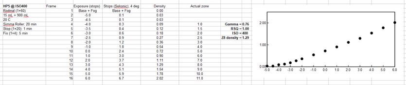

A test roll developed with the Simma is free of defects.
And the higher contrast of the continuous agitation process is still fine for my typical subjects.
If you decide to reduce the contrast, just reduce the development time or temperature.
Will do. At the moment the contrast you see in the above pics is mostly added in post.

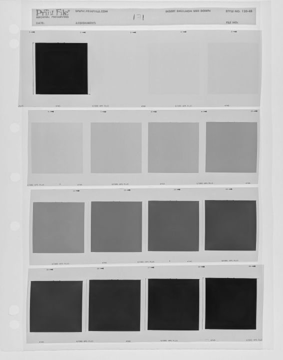

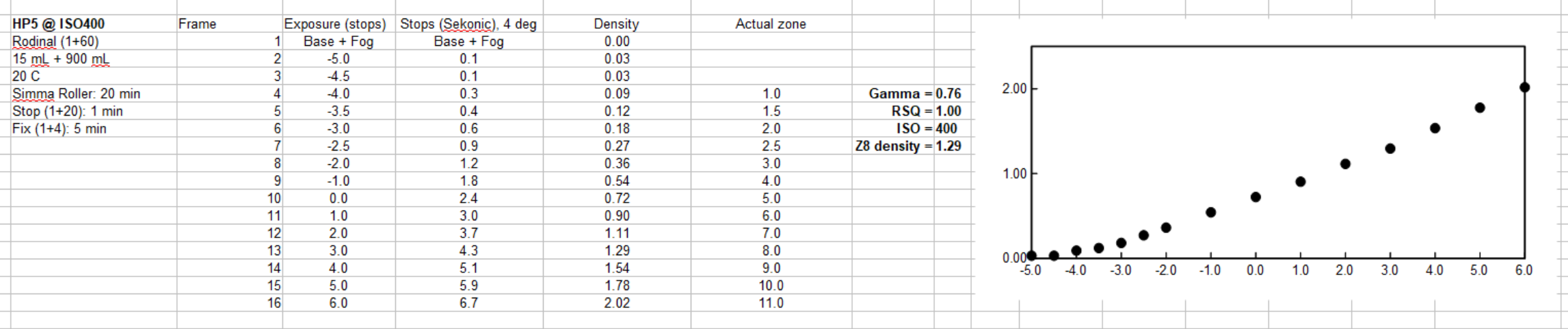

Edit: What am I doing talking about it when I can share data. See below.
