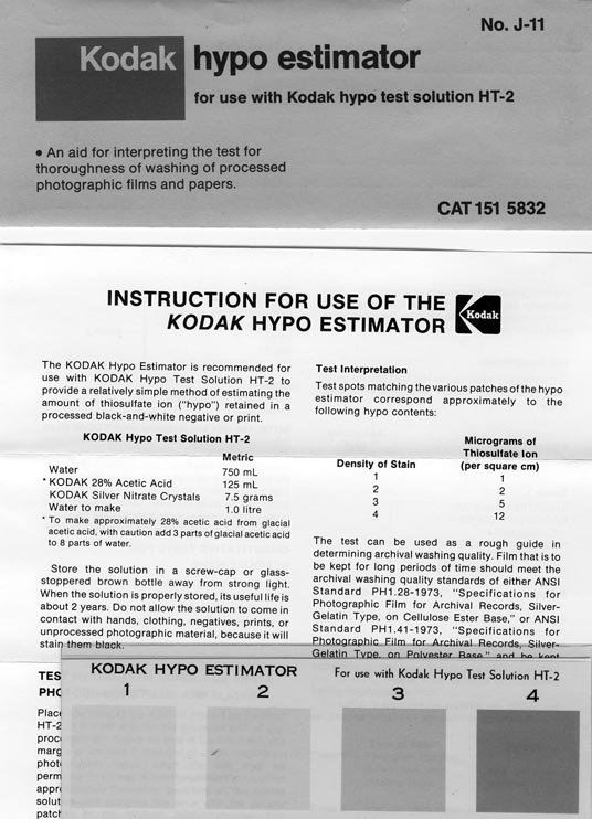

Enclosed is a scan of a Kodak Hypo Test chart. Even though it is B&W, I am sure that you can visualize the densities as being pale yellow to darker brown from left to right.
That is how I test my fixers, my film and my paper for quality of washing.
