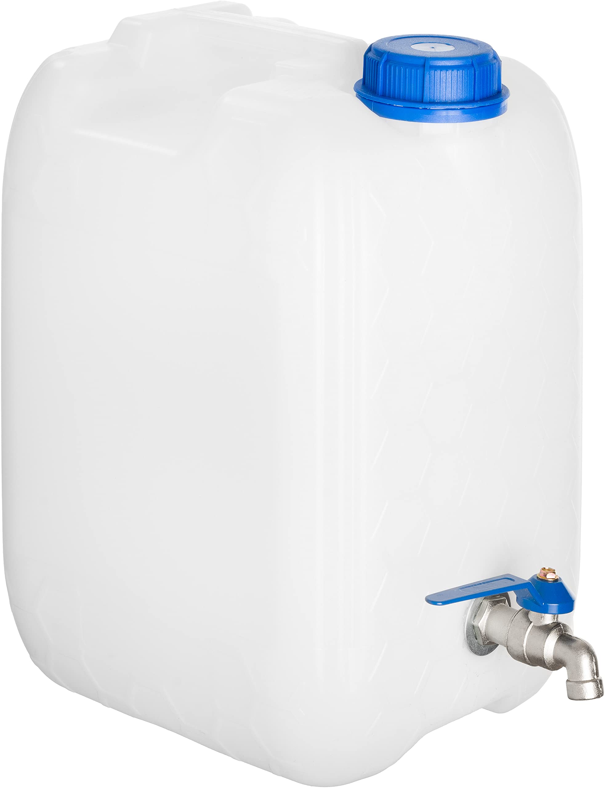

Are you thinking of a big canister like this, with a valve at the bottom, opened just a tiny bit?
Surely you're not thinking of standing there for minutes with a jug in hand, "creating the flow" by pouring water out of the jug?
A jug like that would work.
As will a low flow siphon, or even a jug with a very small hole in it.
An aquarium pump as well.
Anything that will give you a slow trickle of water, down into the centre tube in a developing tank.
