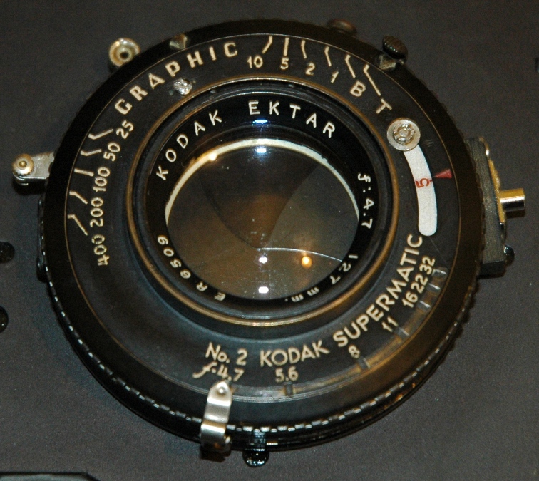

Here's a picture of the Ektar lens. I'm wondering if it is unique or not since every picture of a 127mm f4.7 Ektar shows it as having either a white or a silver finish.

I've seen some on ebay in black. ER puts the lens in 1945 so it might have been a wartime thing (to keep reflections down), but I have ER3544 in a Graphex shutter with chrome. Here's one vintage 1944

Would anyone happen to know what the number 5 is for? I'm guessing it's a flash sync thing but I'm not sure. As you can see in the photo it was modified so that a PC cord can be connected to the shutter and the '5' is right next to this. That number thing is not moveable, BTW.

I've got one just like it. Mine's an uncoated wartime production example. I can't make out the serial # on your lens to determine the date of manufacture but I'd bet it is early to mid forties. It's a very good performer within the limits of it's IC.
On the flash synchromatics I have on my 101mm Ektars, you can very slightly loosen up the screw (above the 5 in your picture), and it should slide down to reveal something else above it. On mine, it's either the letter M or F, depending on the type of sync it can do. I have no idea what the 5 means.
Dan
PS Kodak used a code to date their lenses. It goes as follows:
C A M E R O S I T Y
1 2 3 4 5 6 7 8 9 0
