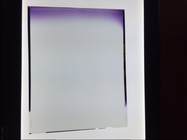

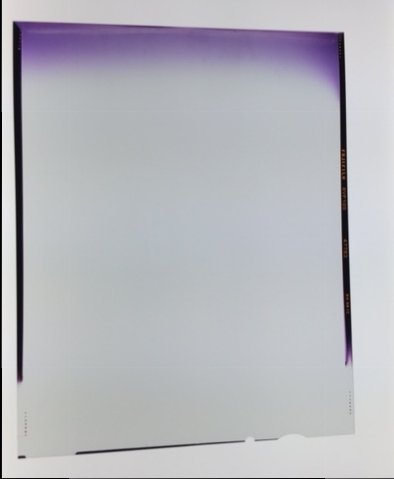

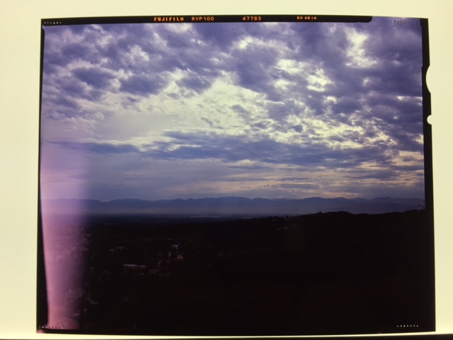

I just got some trial pictures back. Ouch.
There is something wrong here. In all pictures there is some sort of leak on the side where I pull out the dark slide. I am not sure if this is the holder or the camera. In one picture the scene is in focus, but that edge is bleached and purple-ish. Several were also blasted clean (blank) with light, and in this case that leaky edge looks darker than the rest of the frame. Very odd.
trondsi
Jun 29, 2015
454
Before I go ahead and try more film, I was hoping someone could diagnose the problem here. The picture that is blank might have been myself simply forgetting to close the shutter, but what's up with that purple edge in both? This edge is on the side where I insert the dark slide. The pic on top is in focus though (sorry for bad snapshots).

The streaks look like a light leak. The holder may not be sealing properly, or you may be pulling a bit much as shutterfinger advises to be careful of. I've a few holders waiting for me to get a 4x5, but I really haven't played with them, so I can't offer any way to check other than a visual inspection for obvious gaps or wear.
Also, I don't think you exposed the blank one at all - notice you have the light leak, as well as the edge markings (which are pre-exposed at the factory).
BrianShaw
Nov 30, 2005
17,044
La-la-land
That, plus it looks as though the film possibly was not loaded correctly into the holders.
Yes, I just realized that at least some of the sheets were incorrectly loaded. Thanks!
