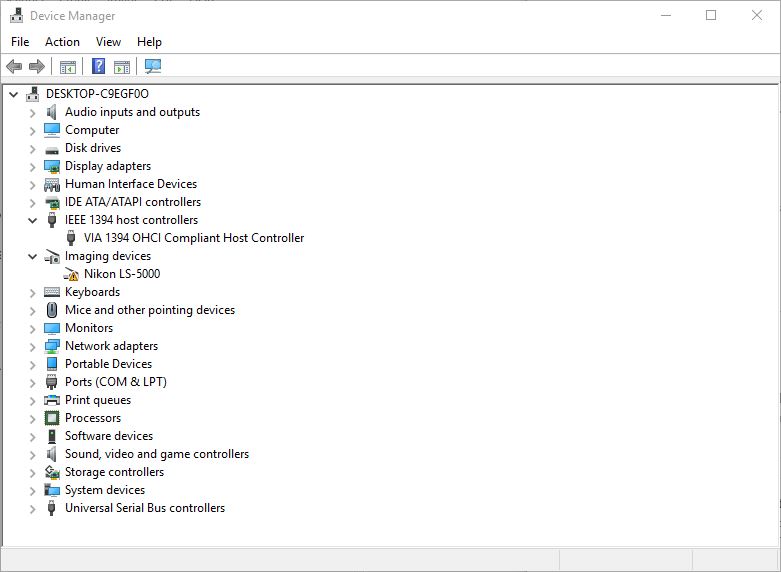

Just got a Nikon 4000 and Vuescan doesn't recognize it. I'm on a PC with Win 10.
My motherboard has a Firewire port, which Device Manager says is active. I know Vuescan has the driver for this scanner. I tried both the 64-bit and 32-bit latest Vuescan versions.
Can anyone point me in the direction to troubleshoot this? Thank you.

Vuescan uses it's own drivers, from what I understand. I would suggest checking the device manager to see if windows sees the scanner. If it does, try removing the Vuescan software and reinstalling it with the scanner hooked up. If it doesn't see it, try a different FireWire cable, move the FireWire card to a different slot, and/or update the FireWire and motherboard drivers. If the FireWire is built into the motherboard, try disabling it in the bios, restarting to let Windows fully load, then restart the computer again and enable the FireWire in the bios.
What does Device Manager show for the scanner? If it's coming up as "Unrecognized Device" or has some other error, try installing the latest version of the 64-bit Nikon driver that you can find: A driver written for W7 will likely work.

My motherboard has an integrated port, which is what I'm using. I've attached a Device Manager screenshot. Windows says I'm using the latest driver.
Device Manager didn't show the scanner, so I used the Actions function to add the driver from the Vuescan list. There was no 4000 driver, so I used the 5000, which I understand is the same.

Still struggling with getting this going. Ed Hamrick kindly sent the drivers directly. The port and scanner drivers are recognized in Device Manager, but Vuescan still doesn't find the scanner. My motherboard has two integrated Firewire ports and I've also added a card and tried all of them with two different cables. I'm stumped but not ready to give up yet.

Still struggling with this. Ed Hamrick kindly sent the drivers and provided some advice. Device Manager shows the port and scanner drivers, but Vuescan still doesn't detect the scanner. My motherboard has two integrated Firewire ports and I've added a card, but no luck with any of them. It's frustrating but I'm not ready to give up yet.
