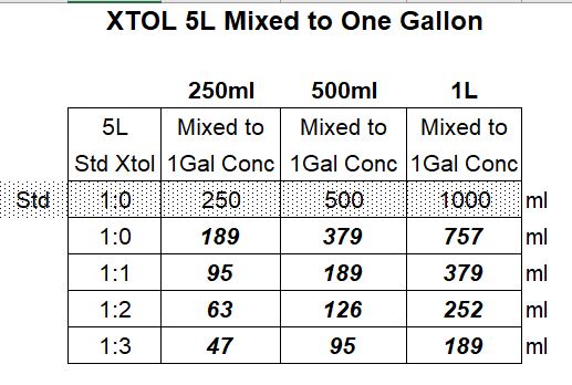

Back when deliveries were sporadic, I checked the Legacy Pro vs Kodak's Xtol. I could measure no difference via densitometer. Long haul consistencies might prove different but I feel fine interchanging them. My routine is to mix the 5L batches to 1 gallon and both seemed to go into solution equally, too.
Just to understand -- you're running your Xtol/Eco Pro at 25%+ above standard strength? Replenished/stock or diluted?
I place the dry ingredients in a 1 gallon glass thumb jug, fill to the 1 gallon mark with warm water and roll the jug back and forth. It leaves little chance for aeration and avoids the cavitation of my magnetic stirring rig (so much volume requires pretty aggressive magnet action). It all goes into solution and I decant to smaller glass containers. Originally, I tried it to see if it would work, back in the era of "sudden failure" issues, thinking that a higher concentration stock would perhaps be more stable. It turned out to be a handier prep for me and worked well in practice so I just settled into the habit. I keep a small copy of the attached grid posted in the darkroom and it's quite easy to mix the adjusted ratios for the dilution I'm after.
Neat. I am not that worried about sudden death or excessive aeration, but a gallon is much easier to store than 5L. Since I'm replenishing, I realized that I simply cannot use up all 5L of replenisher quickly enough. What I started doing is only keeping 3L and discarding the rest right after mixing. It's cheap and environmentally friendly enough to do this. 3L is good for three months, and I like having a fresh batch every three months.
Okay, you're using one-shot diluted developer, and just storing over-strength stock -- just like I did with a 5 gallon batch of Dektol years ago. I mixed it in half the water. Still got some of it, almost fifteen years later, and it still worked last time I tried some (about four months ago).
Picture a Studio Ghibli character with a shiver running down its spine... You're throwing away money! To the tune of five bucks or so every three months, I spend more than that on Bugles from the vending at work (and I don't even like Bugles, but sometimes they're out of Fritos), but still. The extra two liters will keep up to six months in full, well-sealed bottles, according to Kodak. Longer than that, according to actual users.
