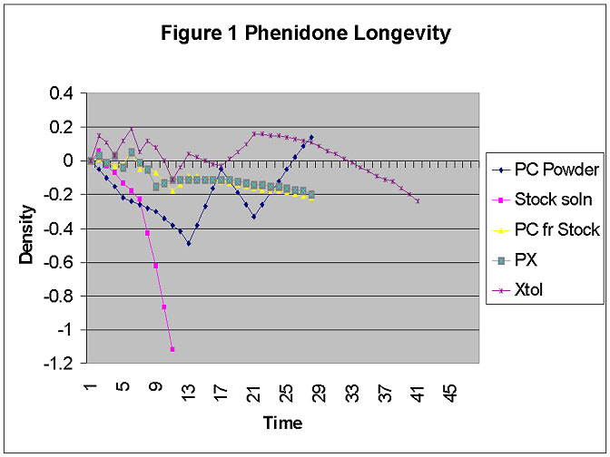

I will stay with Xtol. We always have doubts for the shelf life, and personally I know very well how Xtol behaves when I mix the stock with distilled water.
fig1.jpg https://healthprofessions.udmercy.edu/academics/na/agm/phenvitc.htm
(glass bottles recommended in that article, still some plastic bottles (soda, soft drinks) are also excellent.
Anyway Mytol and Instant Mytol can be excellent choices, mixing just before usage makes it a great choice. Some ingredients can be pre-mixed, specially phenidone to make it easy to dose, or the salts for convenience, so to make the soup we can mix in water the dry ascorbic, the phenidone solution and a concentrate with salts, in that way we overcome the potential shelf life issues of non industrial products.
