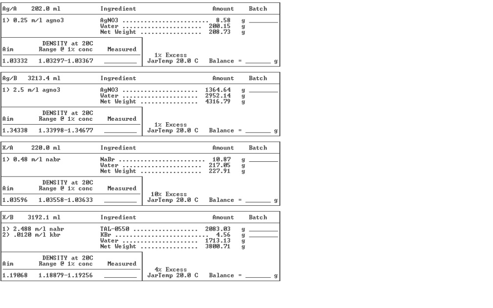

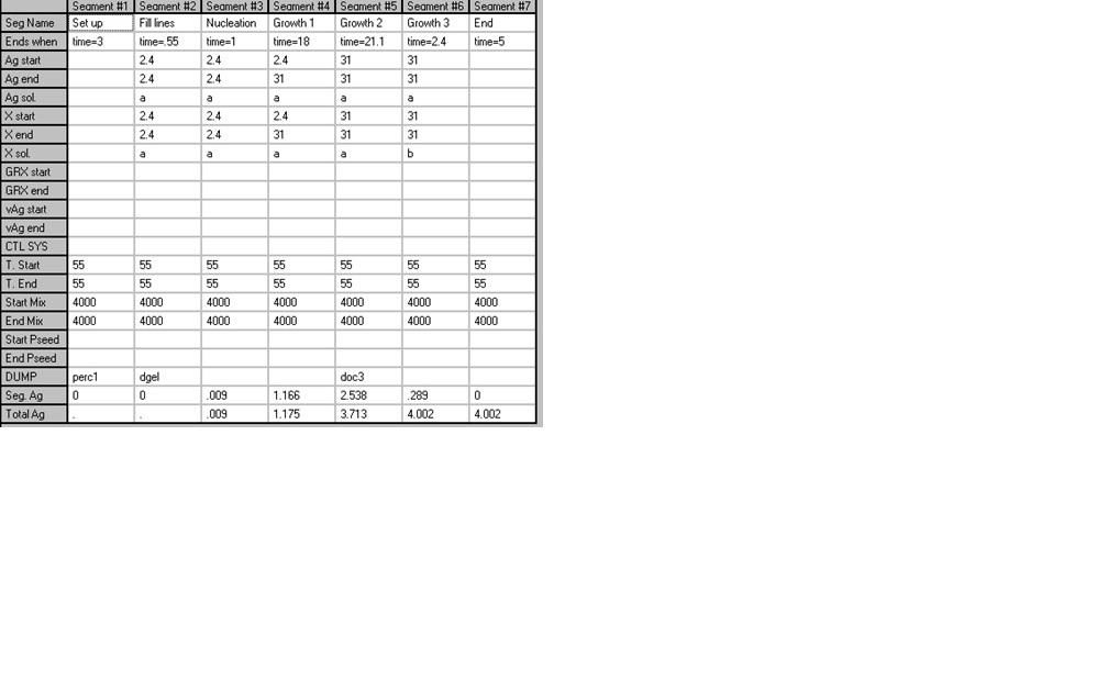

For presentation, I plan on using a spreadsheet format for showing the formula operations and for showing how to make up the solutions. A trial example is attached from my notes.
Comments appreciated.
