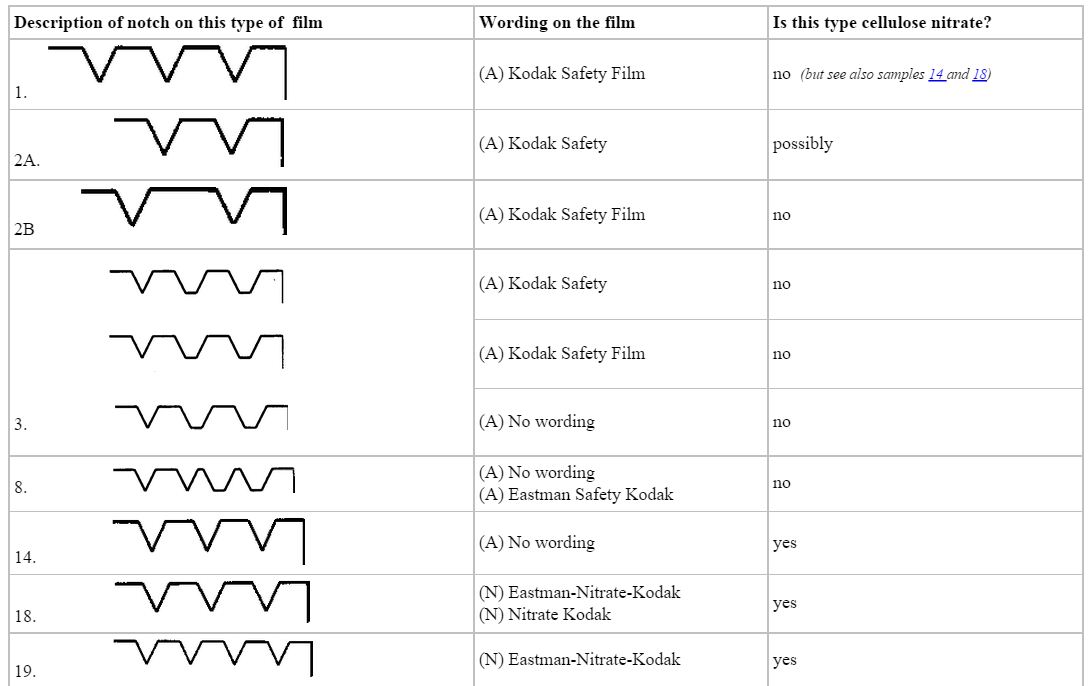

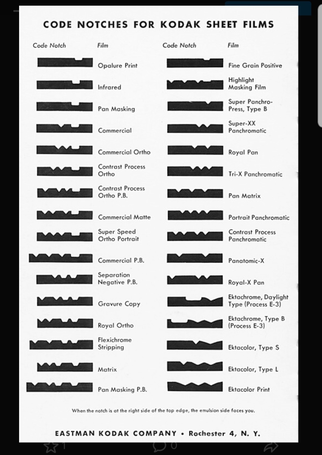

Quick search came up with this link from which you may be able to delve into further references.

Agree - it's definitely *not* a Kodak notch code. I can't seem to find anything pre 1950 relating to sheet film, and sadly, the ones posted here I have already checked (and printed out for future reference.)
Thanks, I checked these out too - and no joy, sadly. However, I have also saved this page and printed out for future reference too.

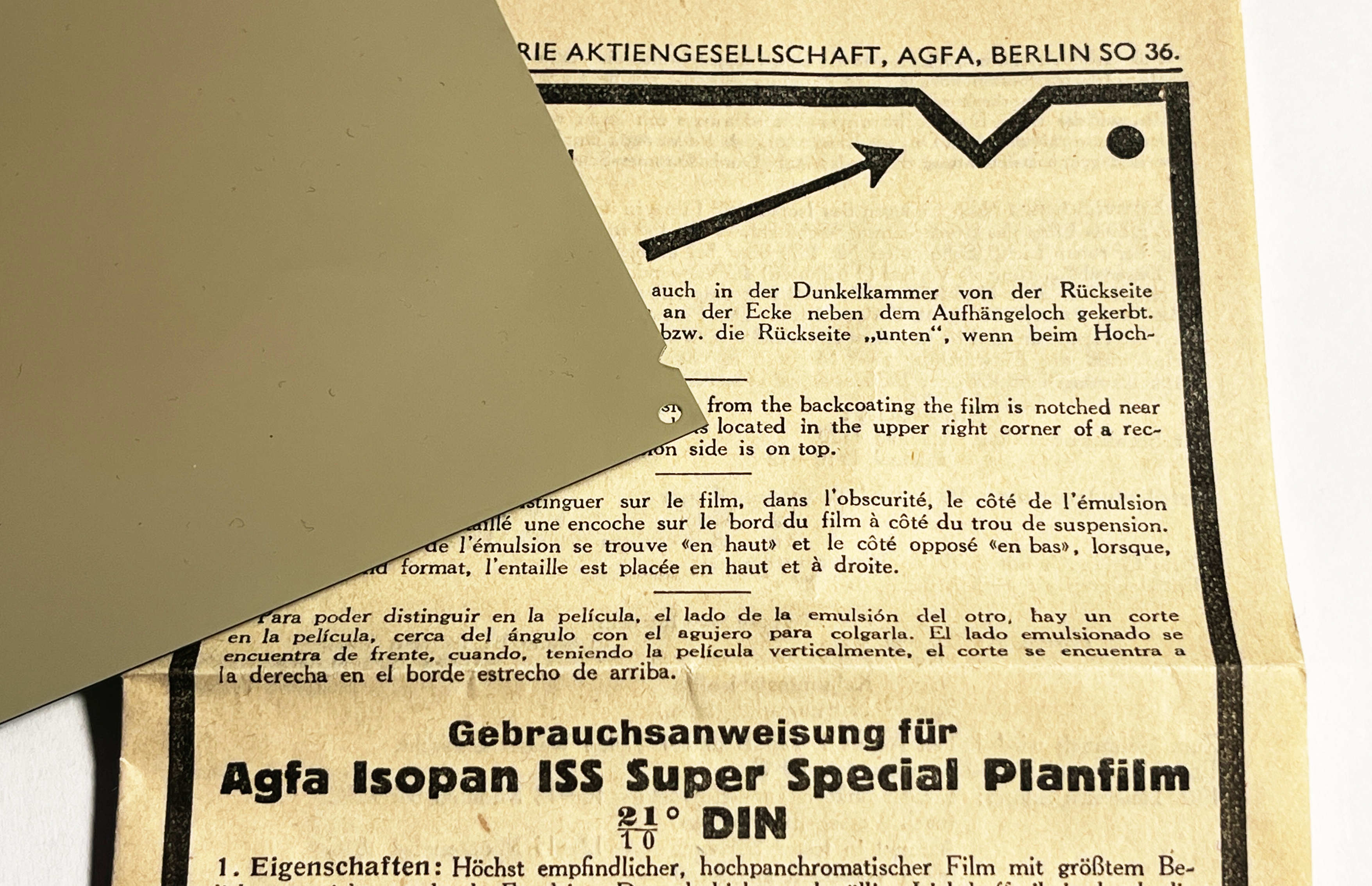

Until yesterday I thought these notch codes are universal, that is, when I loaded 9x12 Agfa Isopan sheet film (best before April 1944) in cassettes for testing. And these circular holes apparent in some old films I encountered when working in archives - I always believed they were some how made during processing.

Thanks for that information, @Jojje. I'll add this to my notes - love that information sheet which illustrates the film's notch code and the extra hole.
Since my initial post, I decided to think laterally and did a search for Agfa nitrate sheet film in German, and this provided me with some excellent results.
For anyone who is interested, I've attached a PDF which has been researched by Klaus Kramer (http://www.klauskramer.de/nitrofilm/nitratfilm_top_04-09.html)
It's an excellent source and with additional information such as the image provided by @Jojje, updating this file to include brands, will be even more useful for archivists and photographer's alike.

I'm sure this Isopan is "Sicherheitsfilm". ISO 3 seemed about right, there was some fog, but seems to be uniform. Next time some Benzotriazole. Interestingly development times in the instructions are given at 18 degrees Celsius, never seen this. Thickness of film is 0,25mm, modern films usually 0,2mm https://www.flickr.com/photos/jojjek/albums/72177720331665348
That is quite possible; an Agfa catalog dated 1941, shows it as being available in both nitrate and safety film.
