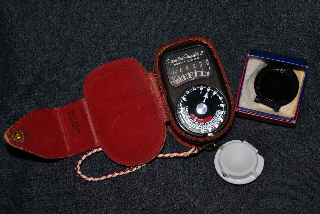

I particularly like the Weston Master III, which is the first with ASA index vs. Weston scale. I consider it a must to have a Zone System scale pasted to the dial. I admit my addiction to Zone System makes me feel lost when the Zone Dial falls off. I usually find the scale in the case or my pocket, lick it and stick it back on.
The meters are accurate when working but some fail. When I get one that's not working I will try and fix it. I have had only two Weston meters fail on me. One due to a scratched coil (scratch which severed a wire) and another that had a dead selenium cell. Generally the Weston and GE meters have well-sealed cells.
An issue of calibration though. Older meters were calibrated to tungsten while modern meters are calibrated to a standard closer to daylight. This means you really shouldn't condemn an old meter for not agreeing with a modern meter.
Some Master II's also had ASA dials.
My Master II works perfectly at 1/3 stop under ISO rating. And the Invercone is the way to go. Great exposure with difficult lighting..........well as long as there's enough of it. :D

I believe some Weston Master II may have ASA dials. Steve Smith apparently has one, because he set his Weston to 80 on Weston Master II and with pointer at 400, he says f/16 is opposite 125
When I do the same with my Weston Master III that is known to be ASA, and I set ASA 80, pointer at 400, I see f/16 is opposite 130. Essentially the same reading.

As the majority of posts confirm, the Weston Masters (any model from II and above) have it all over every (non-battery) meter from the 1960s. I bought one in 1964 or so and still use it. Westons have their limitations, and when I got my first one I had to do a bit of serious reading to learn how to use it properly - the big dial on the front is configured to allow for compensating exposures (plus or minus) depending on the light conditions. Westons do take a bit of getting used to.
My Weston collection now consists of a II (working well), a III (fiddly, correct exposures in bright light but a tad off in low light, two Vs (one works, one doesn't), and a Euromaster (which works OK when I give it a tap). My favorites are the V and the II.
If you buy a Weston, it's good advice to ensure you also have the instruction manual. Be sure to read it.
