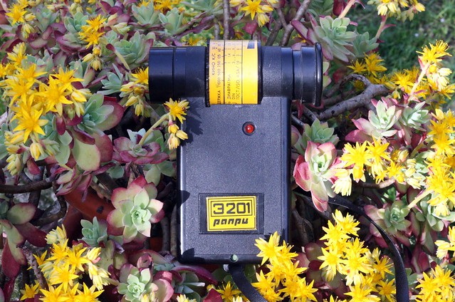

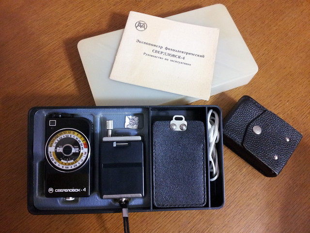

I use two types of light meters Soviets.
The outstanding "Rapri E201" (РАПРИ Э201 ) for Zone System, spotmeter 0,8° !! (10$)
The excellent "Sverdlovsk-4" for incident and reflected light. (15$)
