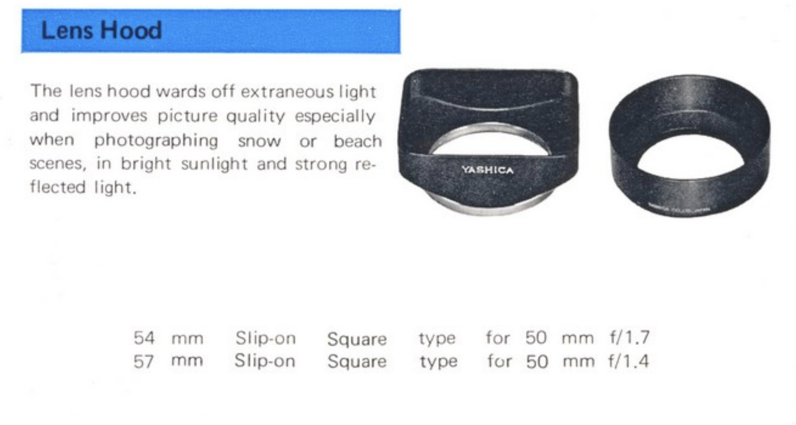

Is it a Contax or a Yashica lens? If the Yashica 28mm, this is the lenshood:
That looks like the one my TLR .
It looks deep for a 28mm .

Actually I'm mistaken. According to the user's manual, that Yashica branded hood is only for the 50mm lens.
So, I don't think Yashica made any lens hoods for the wide angle lenses.
Not sure about Contax; I don't have any Contax lenses.
I use Konica, Pentax, and Miranda slip on hoods matched for 28 and 24mm lens. With a slip on I can use most filters, narrow or wide without any vignetting, the only time I have a issue is when using a polarizer. The Yashica branded 28 looks like a slip on as do the slip on for the 50mms.

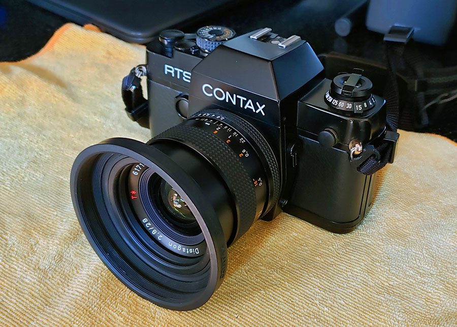

Here's the Contax G-12 hood on a 28/2.8 Distagon. Filter size is also 55mm and there's no vignetting, but without a filter mounted. I don't recall it being too expensive (maybe $20-30) but I'm sure there are sellers who will ask crazy prices because of the name. Many cameras only show 92-97% of the full frame in the VF, so that's not a reliable way to detect any vignetting.

Very nice!
