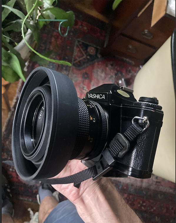

This probably is an obvious "The design just doesn't work" answer, but wanted to check before requesting a return. I recently bought a collapsible rubber lens hood for my Contax/Yashica 28mm lens - 55mm filter size. Just processed a roll I shot with it (the hood was fully collapsed like in the attached photo) and every shot has vignetting. According to the seller, the hood works well for his other customers, so wanted to ask if there's any trick I'm missing for making this work? I dont see the lens hood when I look through the lens.

You really need a lens hood designed for a wide-angle lens. It is unlikely that even collapsed it ever worked with a 28mm lens.
Search eBay for many very affordable options that are much more likely to meet your needs. Term: “55mm wide angle lens hood”
That looks like a nice collapsible lens hood, but the base is too deep for that lens. It would work fine on longer lenses -- 35mm and up.
The reason you can't see the lens hood through the viewfinder is that the viewfinder image is always with the lens wide open. When the picture is taken, the lens stops down and the edges become more apparent.

Is that hood the kind that screws on or the rubber hood slips over the lens? If the latter, it may be out to far. Also I notice there seems to be a lot of depth from what appears to be the end of the lens to where the hood starts. Is there an adapter on the lens or some other filters?

Brian is absolutely correct. You need a filter for a wide angle lens. One wide enough for a 28mm lens.
There are lots of lens shades that have these "deep throats", such as the Mamiya 645/rb67 shades. They are designed that way so that they can be threaded INSIDE the hood, to put on a lens cap or filters -- but if used on too wide a lens will cut the corners -- hence my earlier mention that it has a "deep base".
Good eye! I had a filter on the lens, but I removed it and put the lens on my digital camera and still have some vignetting even without the filter
Ill get a lens hood that is intended for wide angle lenses. The seller wrote "works with all lenses that have a 55mm thread" but this doesnt seem to be the case
