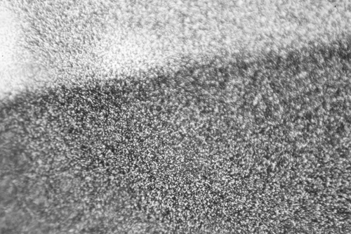

My 1950's microscope is OK for making photomicrographs of edge effects and of negatives of resolution charts but grain(clumps) is a bit beyond it. Attachment,IIRC FP4 in Pyrocat HD with a 40x objective was hard to focus and dim.A modern microscope might do better.
