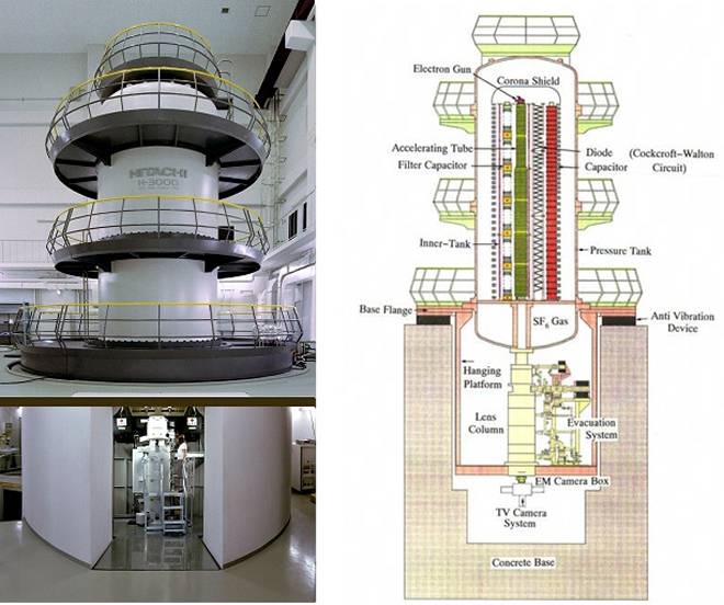

This is a really old thread, long dead even, but I can't resist adding one more comment. Back in the late 1980s I worked for the US office of JEOL. Their main product line was electron microscopes. (That was not the product line I worked on.) They had a photo posted on the wall of the office of an electron microscope they had built. It was a million electron volt microscope that was able to resolve objects on an atomic scale as I recall. The instrument was huge.
I found an description of an even bigger microscope, a three million electron volt instrument made by Hitachi. Here's a link to the web page.
http://www.uhvem.osaka-u.ac.jp/en/what.html
The specified resolution is about 0.15 nm in point mode and 0.10 nm in lattice mode. To give you an idea of the scale of 0.15 nm, it is roughly the diameter of a silver atom, depending somewhat on how one defines the diameter, and 0.1 nm is roughly the size of a silver ion.
I am attaching a picture of this instrument.
Maris
Jan 17, 2006
1,589
Noosa, Australia
Nice picture alanrockwood of the Hitachi H-3000 3MeV electron microscope. I was a sales engineer for Hitachi electron microscopes in Australia and the H-3000 was a required item of study. Actually using EM technology, the microscopes and everything from sputter-coaters to ultra-microtomes, and getting paid to do it, was excellent fun.
