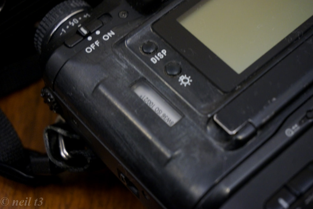

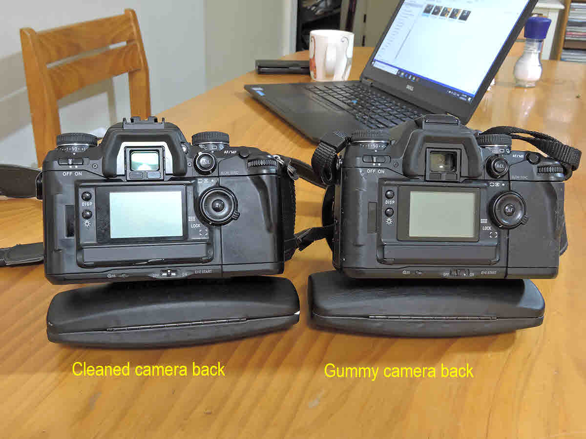

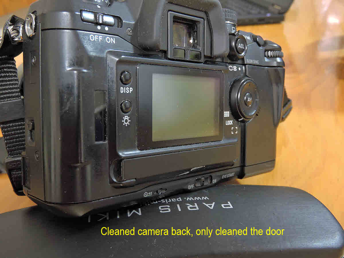

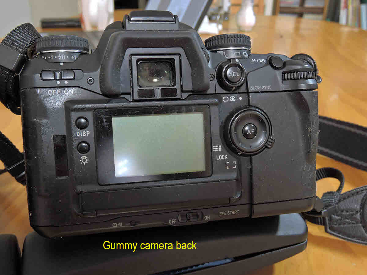

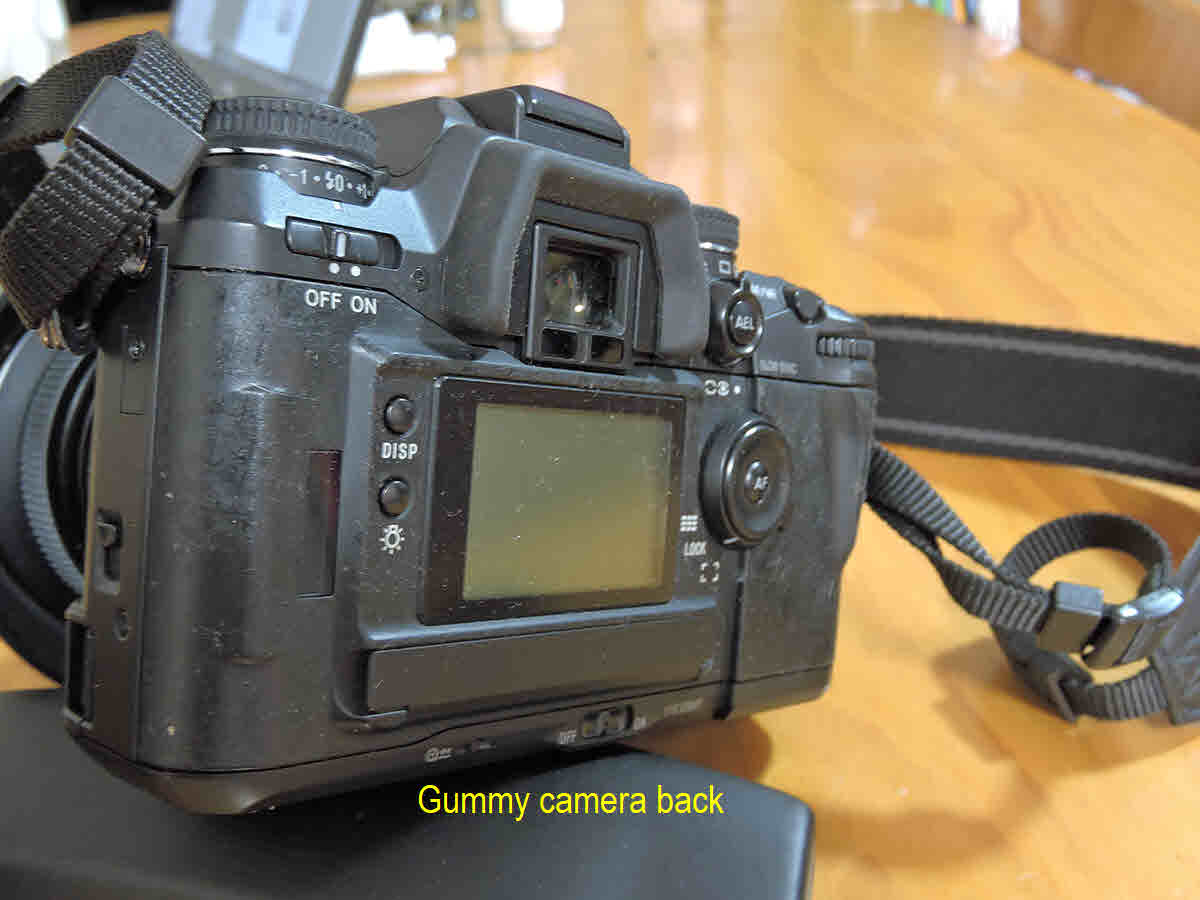

In the case of the Minoltas the coating on the camera back is definitely degraded and if I rub hard with a dry finger I can produce a little ball of coating. The camera back is sticky and unpleasant to hold. This is the situation I am fixing by removing the coating completely. This leaves the bare plastic door moulding on the camera back.

I use IPA with a piece of coarse stocking net cloth ( a dishcloth ) to clean both my Minolta Dynax 7's and a Nikon F80 .
Nice clean and smooth , cleaned up a treat and made them useable again .
Acetone is very dangerous with plastic and can permanently mar it. Be careful. - David Lyga
Acetone makes a mess of the camera for sure . DO NOT USE ACETONE .
The ones I cleaned with IPA have remained unchanged for over two years since I cleaned them , with regular use .

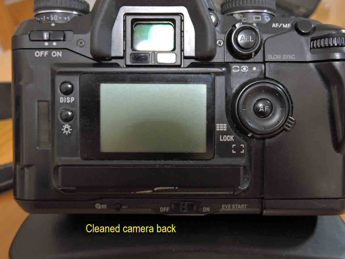

Perhaps many of you already know, but the BEST way to remove that damn stickiness on some newer SLR bodies, usually the AF type, is Isopropyl (rubbing) alcohol. I have tried lighter fluid and it does not work as well as simple rubbing alcohol.
Impregnate a clean, soft tissue with the alcohol and start gently rubbing. The tissue will become filthy, proof that it is working. Be patient, change tissue areas and keep at it. Eventually, there will be no more filth on the tissue, proof that the job is nearing completion. I did this with a NIkon N50 and it worked perfectly. (don't know what brings about this stickiness in the first place, but I have experienced it on many of the hard plastic bodies, even some of the Yashica leather ones as well.)
This problem need not plague us any longer: patience and time (five minutes!) are all that is needed. Heed. - David Lyga
