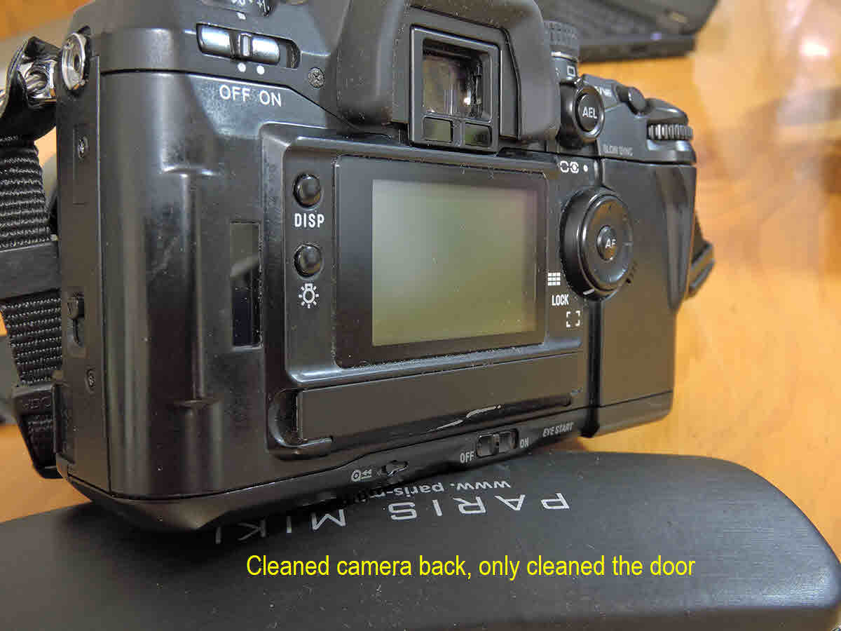

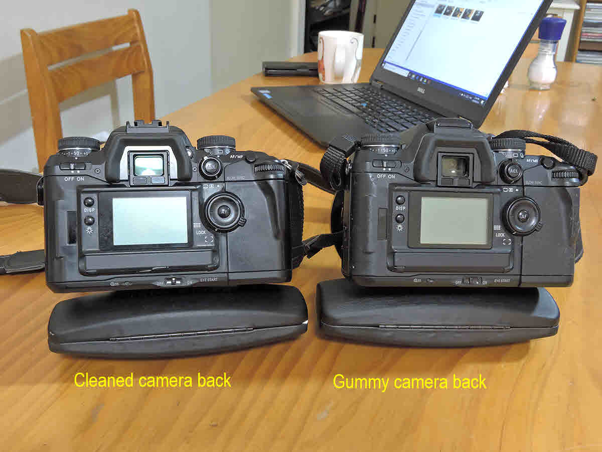

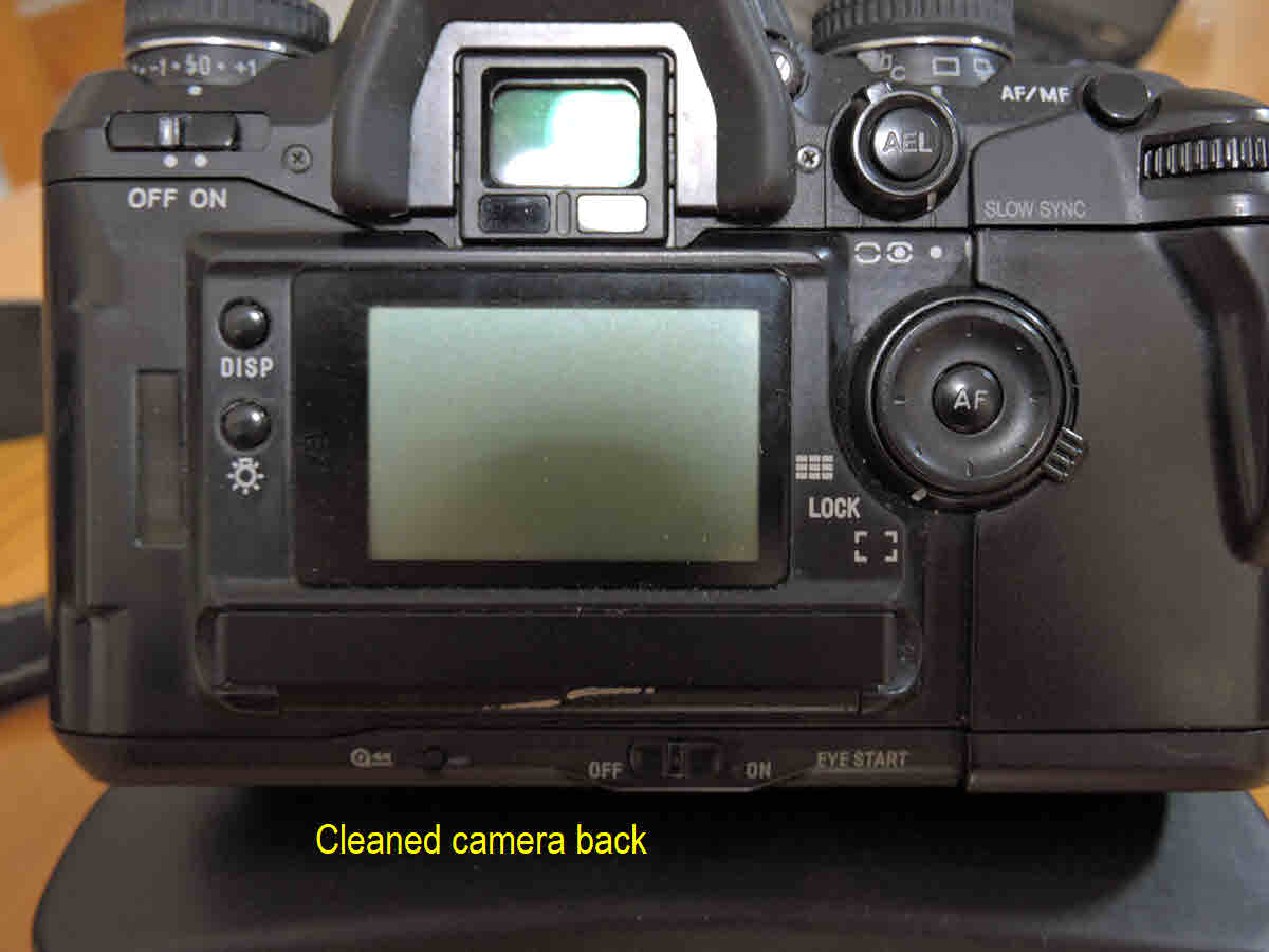

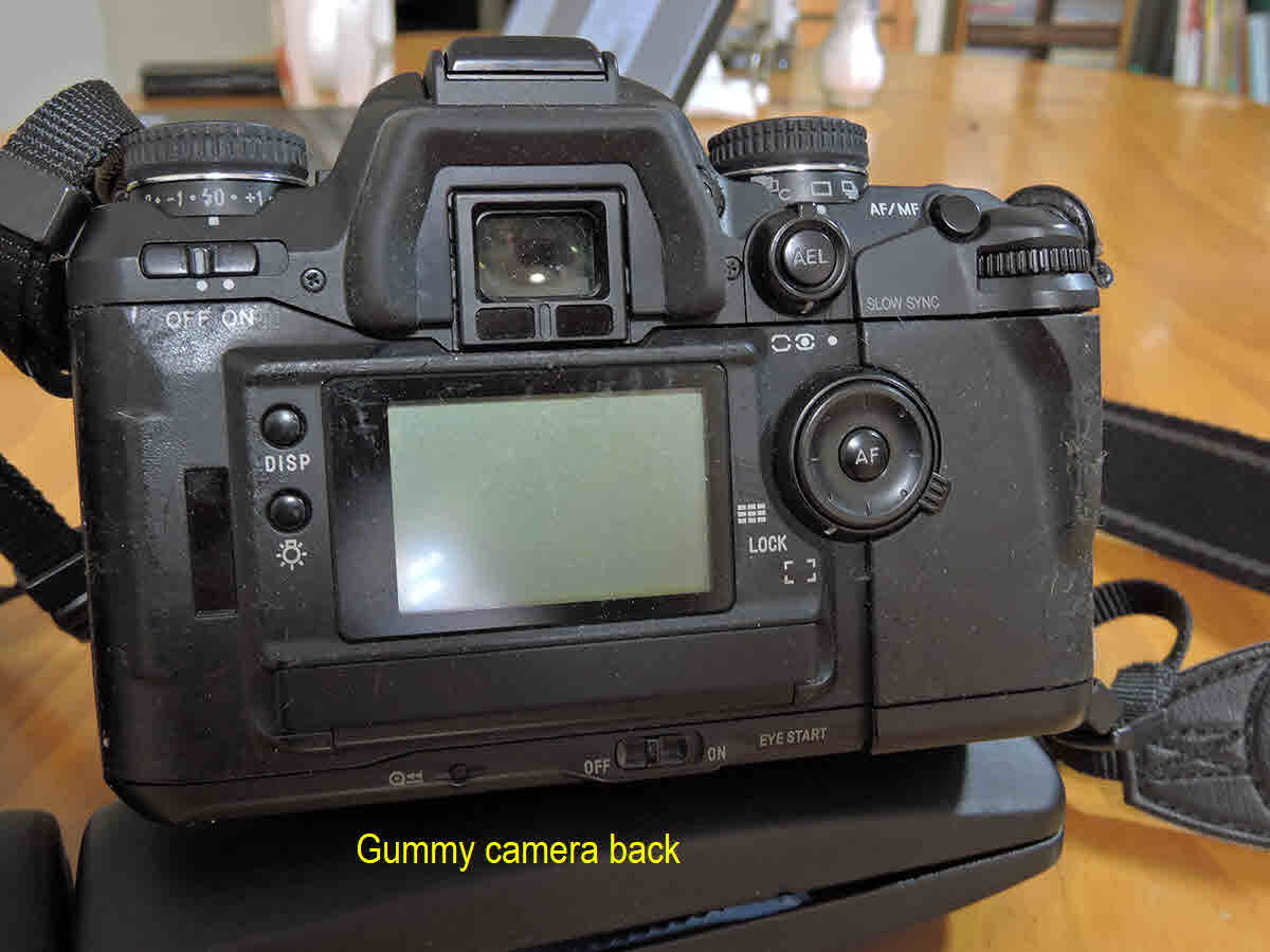

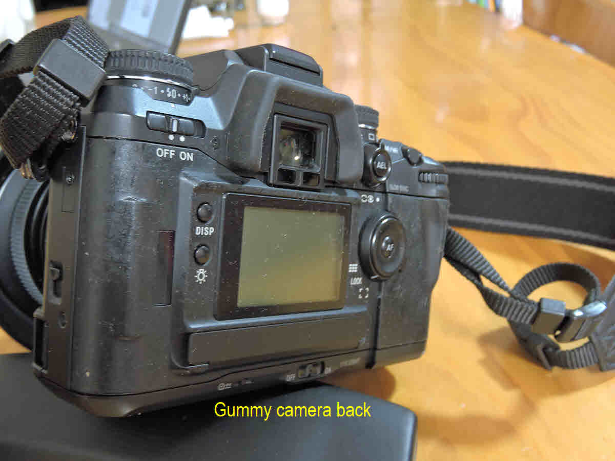

I have two Minolta Dynax 7's that are similarly afflicted. I have removed the sticky rubber right back to the bare moulding on one of the camera backs.
Can't remember which solvent I used - isopropyl alcohol or lighter fluid, (naptha). I used an old soft T-shirt and had to change the cloth patch frequently as it discoloured with the dissolved coating from the camera. Had to be careful around the LCD screen and buttons on the camera back.
This is a permanent fix as all that is left is the bare camera door as it was moulded before being spray? coated with the rubber compound.
I'll get around to cleaning up the second Dynax 7 one of these days. In the meantime I am enjoying a Minolta 807si and a swag of Canon FD bodies. (If anything I find that the Dynax 7 body without a grip is a bit small for my hands. Also have to use the expensive CR123 batteries. My 807si has a grip and I use AA's).

Any photos before and after to show the outcomes? I have had mixed success and would love to see other peoples results with this method.
Hi Sabredog, here are a few
