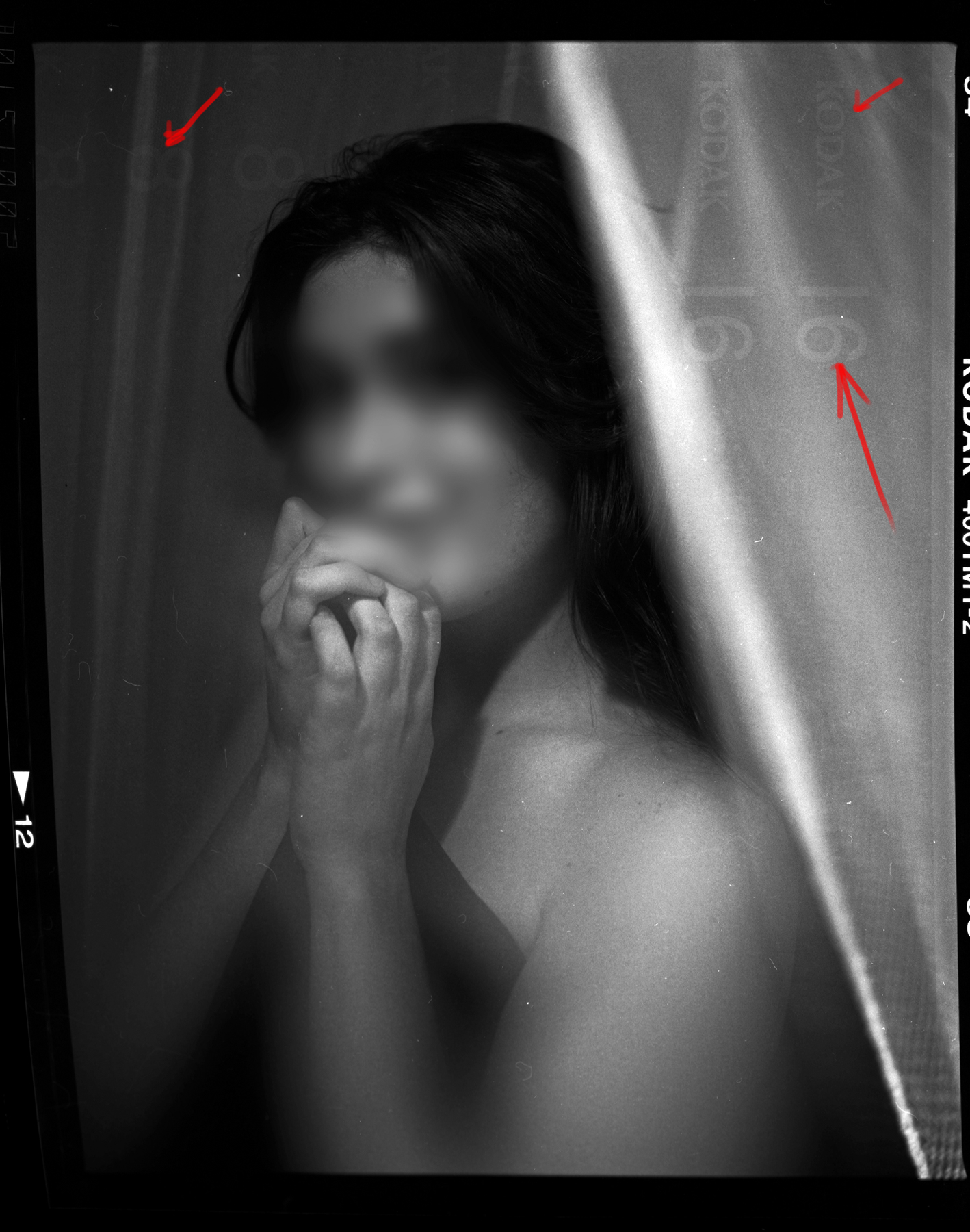

I've never seen this problem before, there are large numbers on the actual negative inside the frame, for multiple frames of this T-MAX 400 film. I have tried to exaggerate it as much as possible, does anyone know what the hell is going on?!
attachment.php
T-MAX 400, D:76 1:1 9 minutes at 68F, TF-4 fixer 8 min
Why would these numbers be present?!

That's a light leak in your camera. Light is coming through and exposing the numbers on the backing paper.

Think "chemical fog". I have seen something on a blog or facebook or something where this happened to someone else who shot with Kodak after their new backing and this same thing happened to their images. It's not a light leak. The ink itself had damaged the emulsion. And that was such a good portrait just to be ruined like that! My condolences :sad:

How could this be a light leak? There is absolutely no strange light leak marks on the outer rebate edges of the frame, or any organic light leak shapes anywhere. The numbers have been printed into the negative perfectly flat against the actual picture...the backing paper would prevent light from hitting the film, and the only way the numbers could burn into the negative at the time of shutter release is if the numbers were actual cutouts instead of ink, but they're not! They're ink!
Sorry not sure I understand. Chemical fog is related to the backing paper? This is the only time I've ever had this problem with T-MAX, what a shame because there are some really pretty portraits on this roll all watermarked by numbers :sad: I bought this at B&H, so weird how can Kodak allow this...

Wow that's exactly what's happening to me, and I'm looking at another roll from the same exact session (but this one is Kodak 100TMX) and it's perfect, no watermarks or light leaks! Can't be my camera...

If post #123 is correct, and that UV discovery looks mighty promising as a potential contributing factor, then the character shadowing would be occurring after the roll is unwrapped but before it's loaded, or after it's removed from the camera but before it's processed. Your closed camera, opaque to UV light, would not be the cause.
If backing paper fluorescence is contributing to the problem, for an opened but unexposed roll one would expect to see a more pronounced shadowing effect in the earlier frames (lower numbered). But for an exposed roll, one would expect the opposite where the later frames (higher numbered) would be more pronounced. Or more likely, both cases might be visible to varying degrees.
Perhaps you could check your character shadows and their corresponding frame numbers for any recurring patterns.
A test might be to open a new 120 roll in total darkness (changing bag or darkroom), load your camera in total darkness, expose that roll normally in your camera, then remove and process the film in total darkness. If external UV light is causing the backing paper to fluoresce and shadow characters, eliminating the UV light should eliminate those artifacts.
[Edit: Performing such a test it would also be wise to load, expose, unload, and process a second identical roll normally (not in total darkness) to serve as a control against which to compare the final results.]

I don't think it is the paper itself (even though that phosphorescence is scary) but the ink. Lots of people have had problems over the years with the numbers showing up on many different films. My stash of Agfa APX400 was perfect for years, then the numbers started showing up on the last few. There are no other explanations for it than the ink used on the paper started breaking down with age or reacted with the emulsion over time.

I strongly suspect that the ink with the film rolled too tightly after being exposed is a likely cause. Siriusly.
It's photographic roll film that is sensitive to light, with backing paper character shadowing, and a potential internal light source. I would never dismiss out-of-hand any possible cause-and-effect relationship combining those specific variables without first testing. Even with the visible characters manifesting as lighter on the positive rendition.
It may well be just the inks. Or it may well be only the light-emitting backing paper. Or it may well be a combination of the two. Or it may be none of the above. Or all of the above, but with a fourth, or even more, interrelated factors involved.
In failure analysis one should never eliminate possibilities without evidence. It's usually not the fault of variables one knows about. It's usually the fault of the variables one doesn't know about. Or never considered as valid candidate variables in the first place. The problem is a problem precisely because unexpected things happened, so best to look at everything before dismissing anything.

I seriously think it's the chemicals in the ink fogging the paper. Has PE not weighed in on this yet? :wink:
That would imply that a camera body is selectively translucent to UV light. Such body is very unlikely.
The transmittted UV radiation then must be too low in wavelenght or intensity to fog the film but intensive enough to activate a fluorescent dye in the print ink. The emmitted light then must be intensive enough to be transmitted through the backing paper and any back layers of the film.
The fluorescent backing paper hinted at above has its fluorescence in the paper, not the print ink.
Any effect then would be complementary to the one seen in the OP's artefact.
I agree...particularly remembering that the ink from the previous layer of the roll is in actual contact with the emulsion of the next layer. I recall mention from Simon, from Ilford, that consideration had to be given to using an inert ink and keeping the quantity of ink used at a minimum, while still giving a dark enough printed numbering to read through a red window on a camera.
