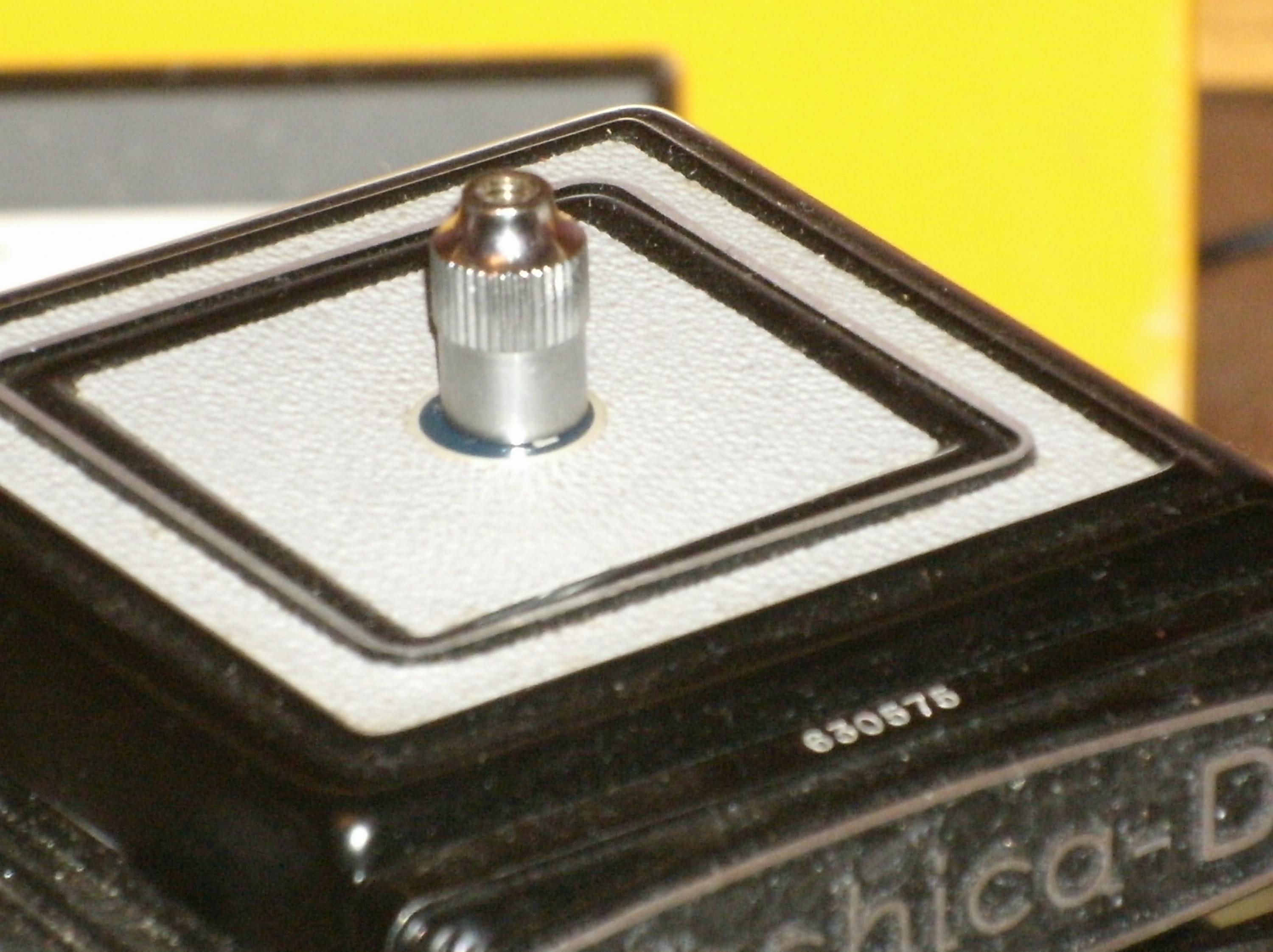

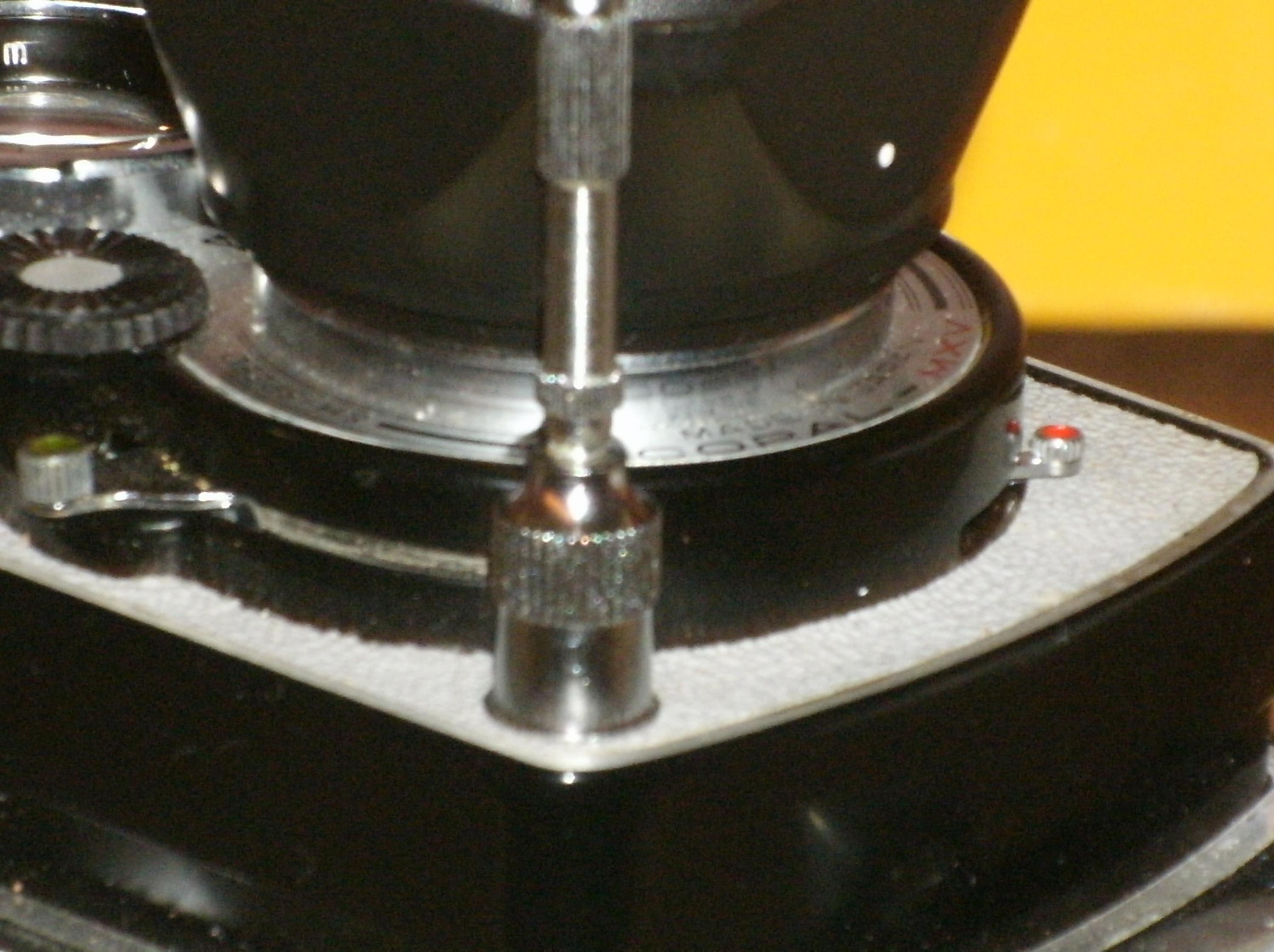

You will need a "Leica nipple" cable release adapter, its the same as the early Nikons used. I will post a pic for you in a few minutes.
This unit screws over the shutter release button. You have to remove a knurled retaining ring first. Care must be taken not to push the release button in while the ring is off, so as not to dislodge the button(old age may have loosened it). You can then screw the cable release into the adapter.
There were a number of Yashicaflex-A variants including the AII. All of the earlier ones, like this one, had the cable release built in where the shutter release normally is (think of basic leaf shutters on folders and view cameras) with the actual shutter button/lever in the middle under the lens. Later series A cameras had conventional button releases (requiring the Leica nipple) like all previous Pigeonflex, Yashimaflex and Yashicaflex models and all subsequent models until the Yashica-24.
