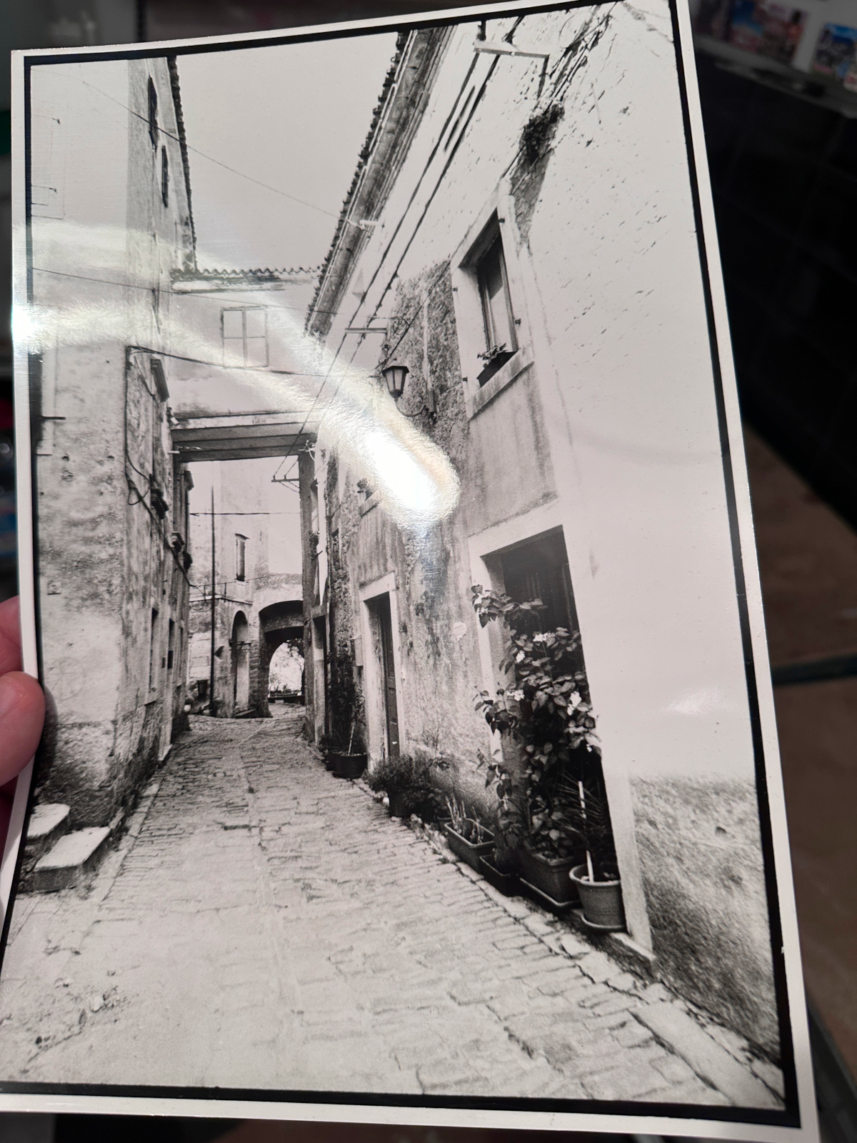

Hi,
I would like to make my glossy print even more glossy, almost like a glass. Something like here:
I suppose that is achieved with hot paper drier, emulsion side on metal? Or?

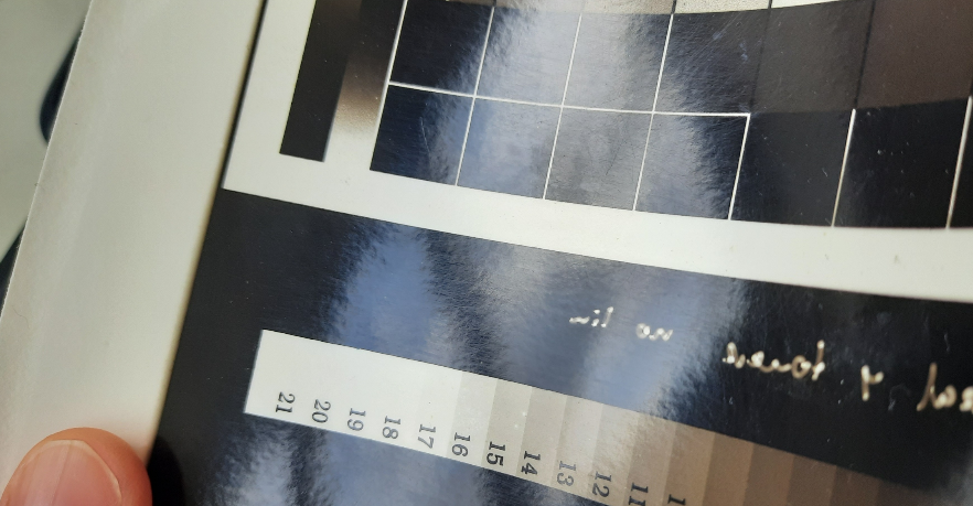

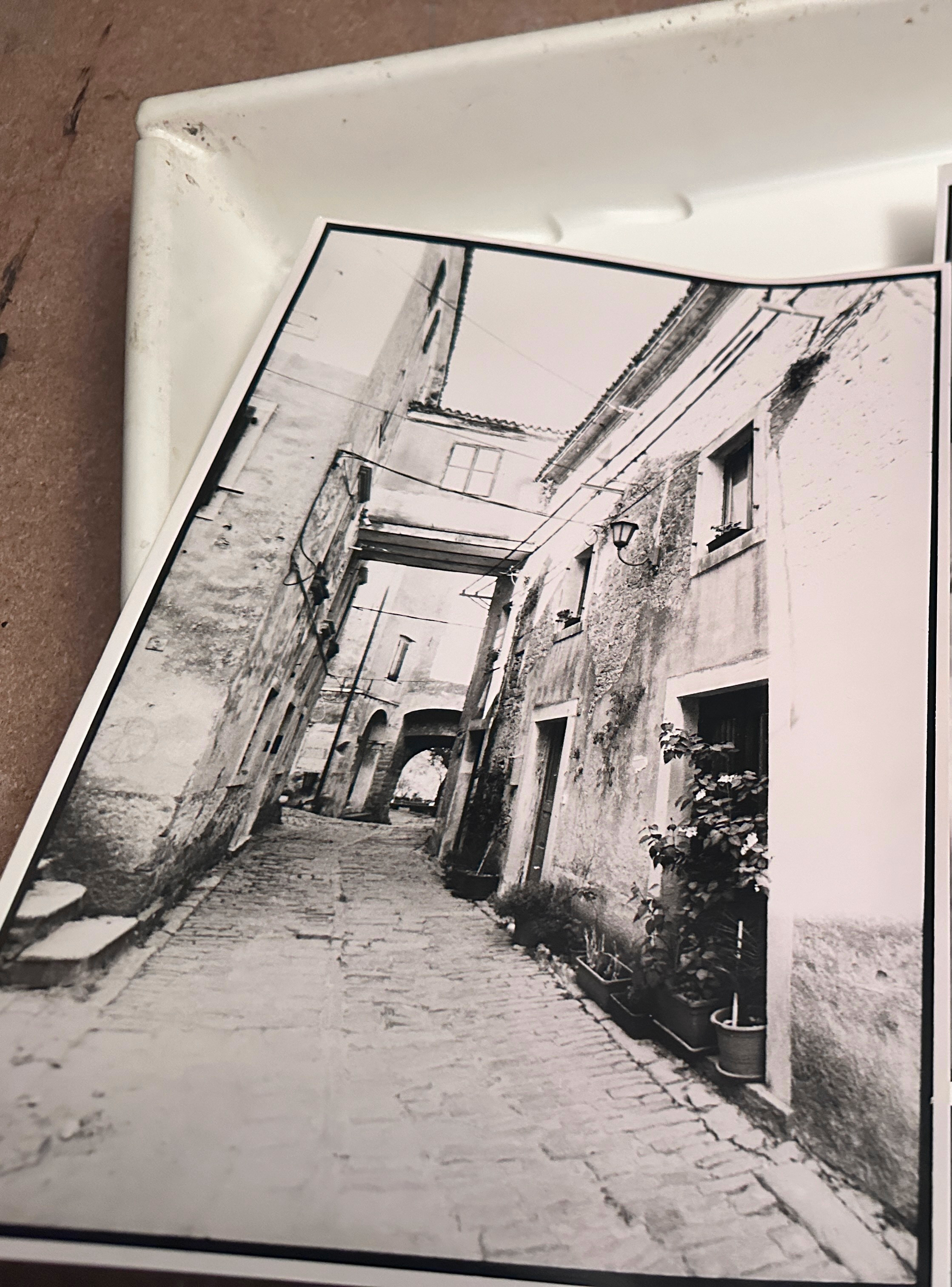

OK, first test of ferrotyping was actually not bad. It is hard to show this on pictures, but here is before and after. Test print was 20x30cm in size, and after looks very similar to high gloss of RC paper, it is not extreme, but definitely more glossy than without.
