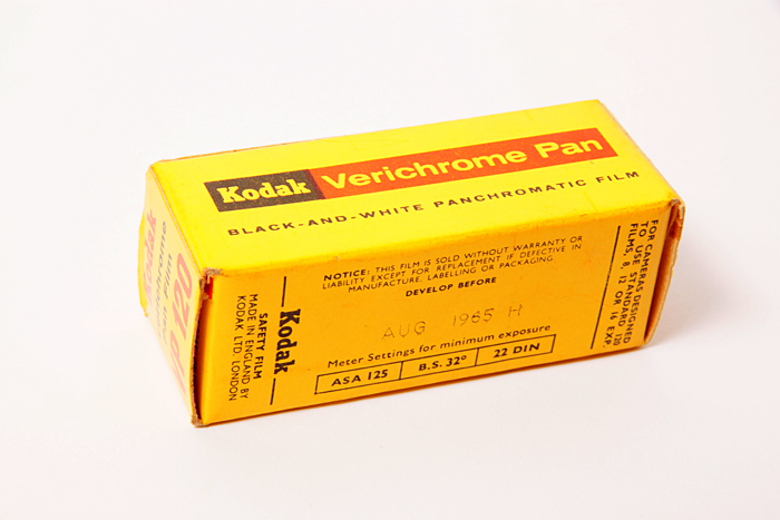

Actually a dumb eye-catch attempt to attract readership for my question. The question that I never knew an answer to: What was the difference between Verichrome Pan and Plus-X in the 1960-s till VP was finally dropped? Both 125. Both development times for D-76 and Microdol were the same. But what was the real difference? Just the printing on the box and paper backing? And last question. Why is it that I'd rather have VP than PX or Tmax?

Verichrome Pan was really effective in box cameras and when used in situations where accurate metering was difficult. It emphasized latitude and exposure "forgiveness" over concerns like sharpness and fine grain.
Plus X was capable of better results when exposed accurately.
IIRC, the two also exhibited slightly different spectral response.
