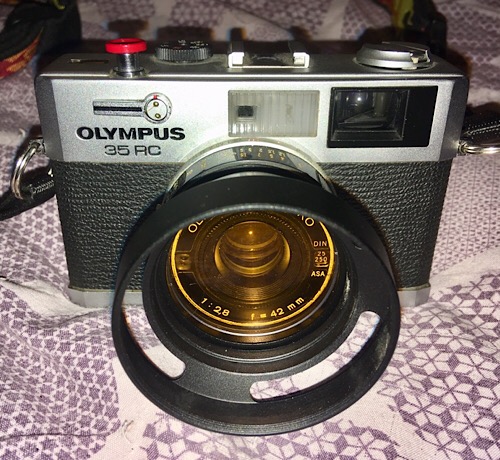

What is the purpose of this type of hood.?
Sorry if "vented" is not the right term, but you guys know what i mean.
They look like this...............
Thank You
They are meant for use on rangefinder and viewfinder cameras on which a normal, solid hood would block part of the frame when looking through the viewfinder. They’re actually quite effective.

Yes, that’s exacty right.
You still see it in the frame, but it blocks so little of the viewfinder it doesn’t really get in the way of composing the image.
Oly RC rangefinder.

None whatsoever. It will work just fine on an SLR.
That common lens shades are are not slitted has a reason: to give better shading.
The best lens shade design is not only closed, long, but not vignetting, but also shaped according to aspect ratio. Something rare in still photograhphy, but common in cinematography.
If you're using that style lens hood to close out the surrounding light while pushing the lens up against a pane of glass, like when you're trying to photograph fish at an aquarium without getting reflections in the glass, it can cause a problem. If the sun is directly behind you and shining light through the vent that's reflecting off the front lip of the hood, that can also cause a problem. But those are two rare circumstances.
It depends how these slotted shades are designed. It seems most actually do not allow light from the side to enter the lens directly. Those indeed would work like a standard, closed shade. Except for the rare cases Jim just explained above.
But are all those slotted shades that well designed? On many photos of these that is not clearly visible.
Furthermore, if only using them on one lens, with stationary front ring, one could tape all unnecessary sloted parts.
I use them on all of my rangefinders. There is no reason to use them on SLR’s.
Not so rare among rangefinder lenses. Modern Leica made often have these hoods and third party 3d printed are available.

I have a bunch of them for a variety of rangefinders, many of which are cheap Ebay/China knockoffs, and have not noticed any flaws in design. They do what they're supposed to do provided you match the right type of hood to the lens according to focal length.
Unless, of course, you already own one and it fits on a lens for your SLR, in which case, why not?
