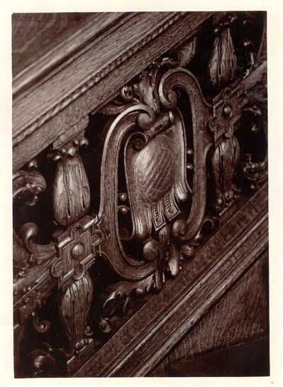

MEANWHILE in the real world, experimentations happened. First try was Polywarmtone PW-17 (ivory, semi-gloss) dev in PolymaxT. The paper came out of the fixer perfectly neutral black. It was then hypo-cleared and rinsed thoroughly, then toned in selenium and rinsed again.
The image is now a very rich chocolate brown that has faint traces of purple/red, but very faint. Compared to a neutral tone paper toned in selenium, this is the real Brown. A scan will come eventually, but this has proved so far that toner really made the warm tone be.
Next test will be the same paper in Dektol, then selenium toned again. More scans to come.
Here's a scan of PWT toned in selenium. I tried everything I could with Kentmere WT to obtain a tone, but it would need a different toner, for it stays reluctantly neutral.
