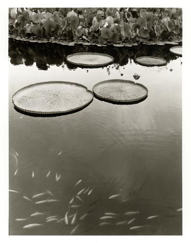

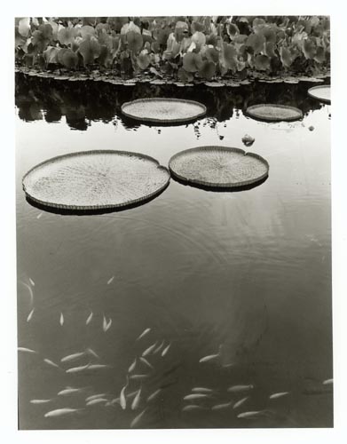

I am in the middle of performing a toning/developer test. I am skeptical of the argument that dektol is a better development selection when using a warm toner. The attachments are representative of the first level of testing. These are prints made with Forte PWT. One print (The warmer one) was developed in Asco 135 that was modified by replacing the Sodium Carbonate with Potassium Carbonate. The Ansco 135 is what i've been using lately. The cooler print was developed in D-72, a very close if not identical match to dektol.
The print developed in Ansco 135 required 10% more exposure. It was processed for 2 minutes at 68F 1:1 using a #2.5 Ilford filter
The print developed in D-72 was processed for 1.5 minutes at 68F 2 parts water to 1 part developer using an Ilford #2.5 filter. These are both straight prints.
Tonight i will tone each print in Nelsons to determine if there are any differences.
BTW, the Anso print is displays more subtle gradation in the highlights than the d-72 print. The d-72 print is very nice, but has a slightly harsher look to it. This may be a subjective call, but it is one of the reasons I have steered away from Dektol.

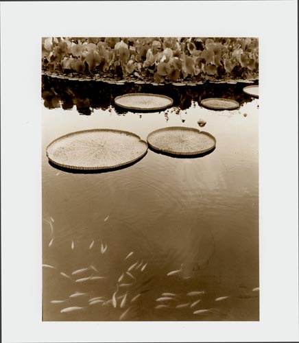

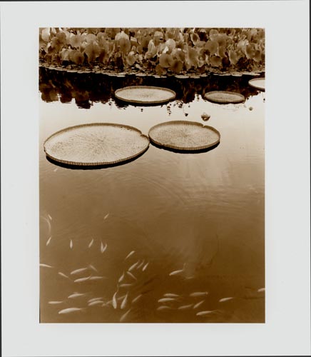

OK here's the test I ran comparing toning prints developed in Dektol and modified Ansco 135. It was stated in this thread that when using warm toners it is best to use a developer like Dektol over a warm tone developer. I have been printing on Forte PWT for about 11 years. I generally use warm tone developers with it. Invariably I tone with Nelsons Gold Toner, which is a warm tone toner that contains AuCl as well as silver nitrate, Ammonium persulfate, NaCl and sodium Thiosulfate. This toner is capable of producing very warm tones on most papers (but not all). It also has the ability to increase contrast and dmax of the print. This is not your average warm tone toner.
The stats on the prints:
film: Foma 400 120
Film developer: Pyrocat
Paper: Forte PWT
Paper developers: D72, Modified Ansco 135 (Substitute Potassium carbonate)
Toner Nelsons Gold Toner
The prints were developed in each developer to closley match contrast and density. I visually matched a highlight, midtone, and shadow density. The prints were straight prints. No manipulation. The Asco print was warmer than the D72 print. Subjectively, I felt the D72 print was a little harsher But the difference was very slight.
The prints were then toned in Nelsons for 5 minutes at 110F. The results show a warmer look with the Ansco print. Density and contrast is virtually identical between the 2 prints. In reality, I could probably have matched the color as well, by increasing the toning time of the D72 print or decreasing the toning time of the Ansco print. Nelsons will give a range of tones starting as early as 30 seconds and going up to 20 minutes.
This test indicates that for this paper/toner combination, there is no density advantage to using D72 over Ansco 135 when printing.
I have used most warm toners, including sepia, polysulfide, and thiourea based. I much prefer the Nelsons over any of them. It provides the increased depth that you can get from gold toning while offering a range of warm tones.
The order of the examples left to right:
Untoned D72 print
Toned D72 print
untoned Ansco 135 print
Toned Ansco135 print
