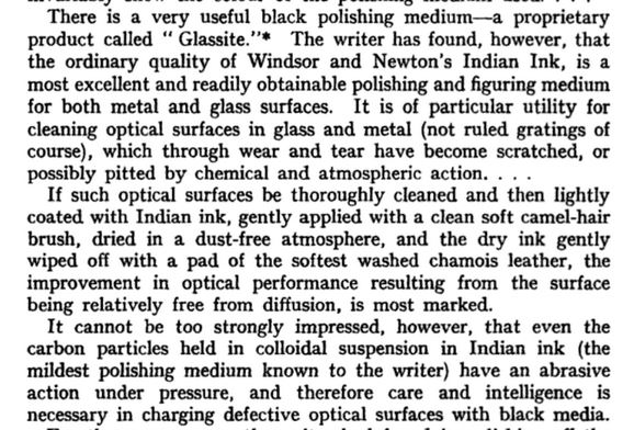

Thinking of shooting a few shots with the lens shade and then trying the India Ink trick for a few shots to see what transpires.

Prism and Lens Making, Second Edition: A Textbook for Optical Glassworkers
By Twyman F
Anyone have a preferred India Ink type they have used?

Well the ink trick did not work; no starter.
The abraded area took the ink quite well, but the abrasions are so shallow the ink is either on or off.
I tried it several times and it would not wipe off the area without a solvent; probably because there wasn't any real original surface area of the lens surface to allow the cleaning cloth to glide over the abraded area and leave ink behind.
I can see how it would work for a well-defined scratch or even a crack, but not for an overall abrasion.
