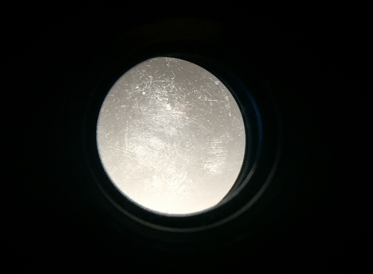

Wow. Bad news on the Rolleiflex 3.5! Finally got a roll of Ektar 100 processed and I think this camera is going to be a shelf Queen. If the damage had been a little more even, it might be somehow justified as a portrait camera for vain old men and women, but the pattern is too irregular and blob-like.
Too bad, the body is in fairly good shape...
Fill the scratches with india ink. This works for large deep scratches. Don't ask me how I know.
I've never tried it on a lens with many shallow scratches but if you want to use the camera its worth trying.
I have to wonder if I will have any image forming glass left over at all...
View attachment 238835 View attachment 238836 View attachment 238837
Thanks for sharing these...pretty interesting results. I would not have guess that the effect would be as non-uniform as it is. Too bad... :sad:
