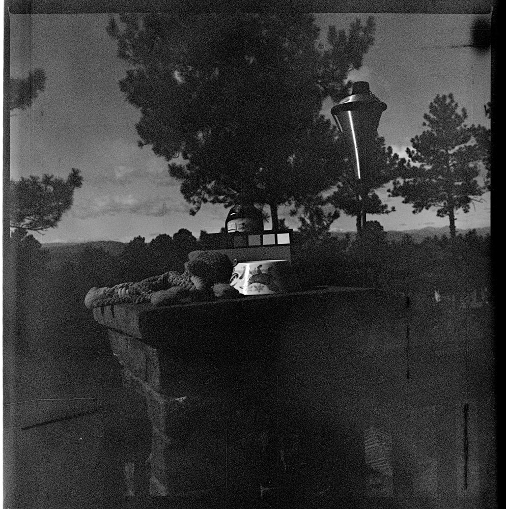

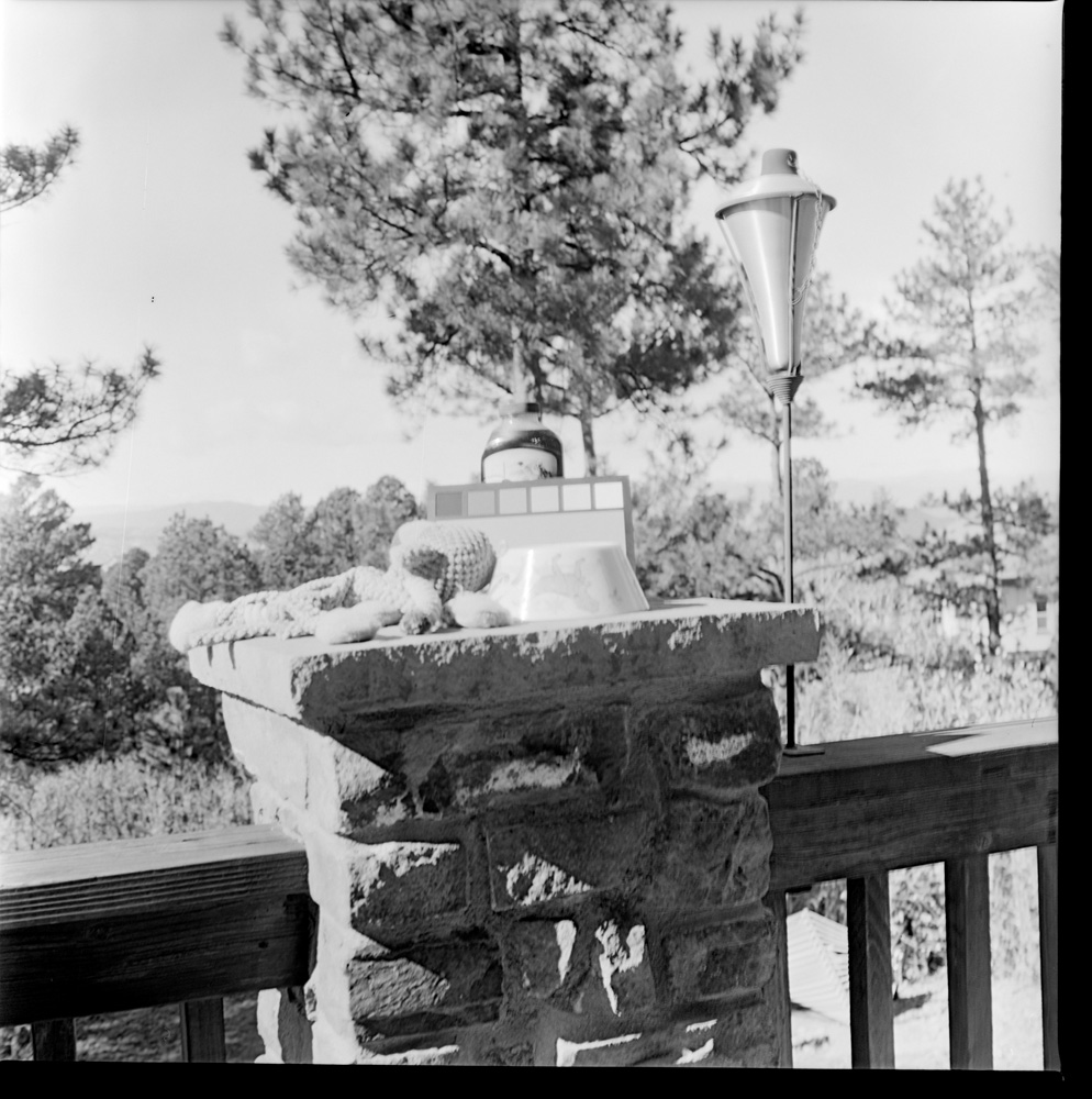

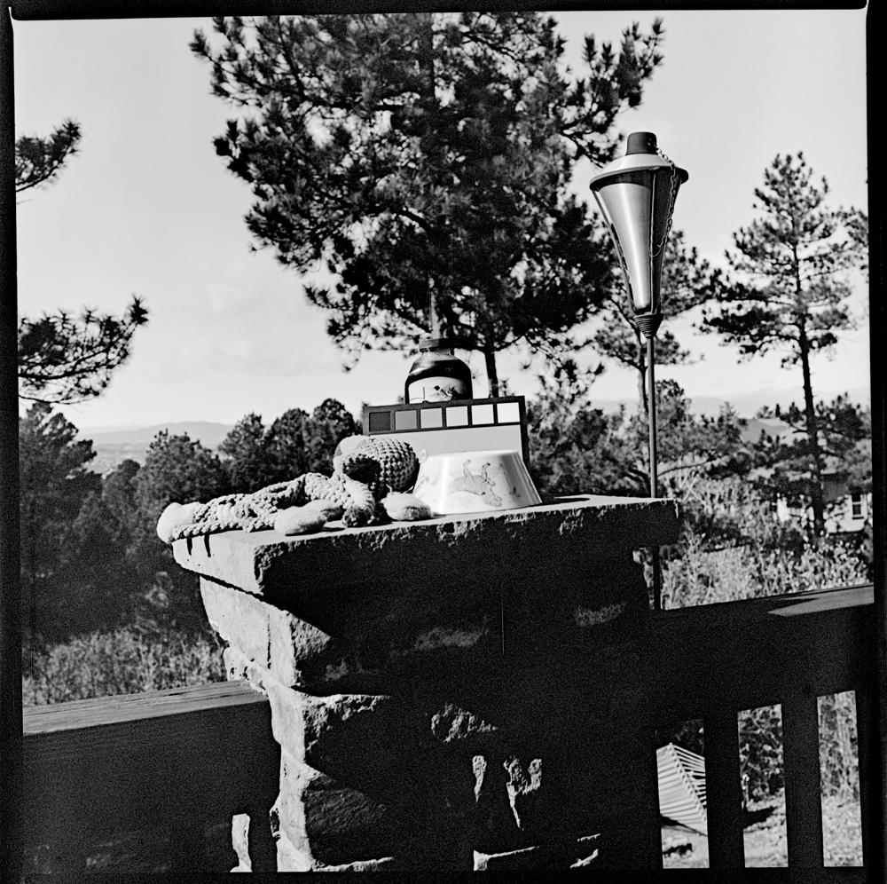

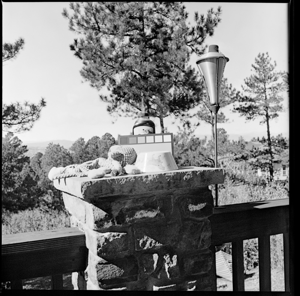

Here's my results thus far. Developed in PMK 1:1:100, 15s initial agitation, 4x agitation every 2 minutes, 5 minutes total, temp around 70F. It's a scan of an 8x10 print (actually had to go to grade 3 because at 2 the contrast was a bit flat) and was shot at ISO 3 with daylight balanced light source. Grain is fairly clear under a loupe, but invisible to the naked eye. Also, most of the dust and scratches were on the negative. I wasn't too careful with it since it was just for testing.

I'm going to bump this thread to hopefully get the answer to a question for trying to get PMK to work for pushing film..
I've been using PMK mixed 1:1:100 instead of 1:2:100. This because I'm developing Ortho Litho film which is super high contrast. Using only 1:1 seems to give this film a reasonable amount of contrast and exposure latitude, significantly more so than any other developer I've seen.
Anyway, I've been trying to push the film since I have like 8 rolls I need to burn through for testing. I'm trying to get at least to a speed of around 25 or 50 ISO, even if it comes with the normal effects of pushing like lack of shadow detail, increased contrast, and increased grain. I've tried the following, all mixed 1:1:100 and at a room temp of around 69F:

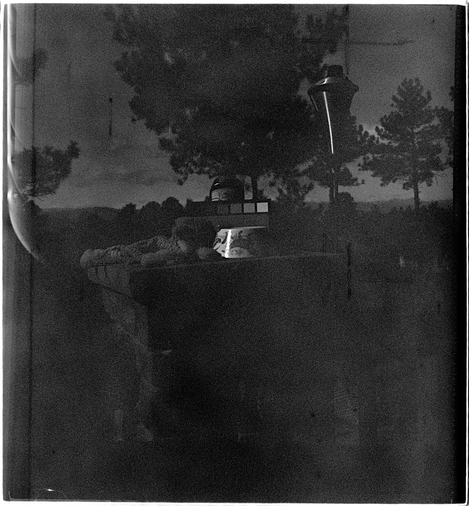

Stand development, 1 hour total time. 30s initial agitation. -- Results: Very heavy chemical fog. Extremely exaggerated edge effects, made even more extreme by the base fog. ie, there is base fog through most shadows, but then when shadows meet highlights the film is clear with no fog. Also seems to have a solarization type effect. Beyond these flaws, it did seem to bring out all the speed the film had available, producing visible shadow details up to ~50 ISO. The fogging and edge effect of course makes this impossible to use for anything though

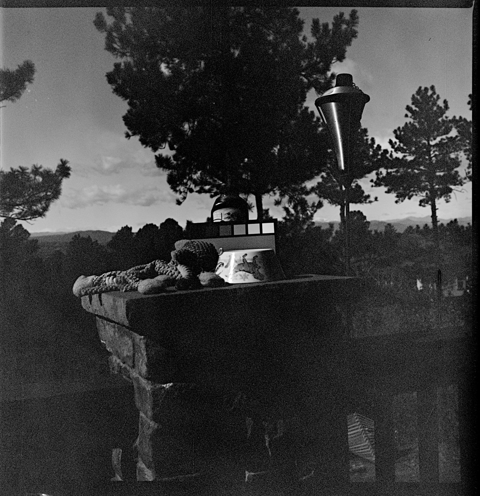

Normal development, 20 minutes total time. 15s initial agitation, 4x agitation every 5min -- Results: Very heavy chemical fog, bad edge effects like with stand. Base fog seemed to kill any speed increase given. Only one or two pictures exposed around 0.5 or 3 ISO are visible. One picture shot around 12 ISO has some very faint highlights visible
Normal development, 10 minutes total time. 15s initial agitation, 4x agitation every 2 min -- Results: best yet, but still not perfect. True fastest speed seems to be around 20 ISO with a decent amount of mid tone detail and a usable amount of shadow detail. Not heavy, but a noticeable base fog. Much more subtle edge effects, but still present where shadows around highlights are clear without the base fog. Very grainy, even at 120 sizes (grain literally visible to the eye). Good sky highlight detail even up to ~75 ISO, though practically no shadow or mid tone detail.
Normal development, 5 minutes total time. 15s initial agitation, 4x every 2 min -- Results: This what I normally use with this film for consistency. Problem is that it's very slow speed. 3 or 6 ISO is decent, but 1.5 or 0.8 is better. Very slight base fog, not noticeable. Flattering and very subtle edge effects. Can handle at least 10 stops of over exposure without significant loss of highlight details.
Anyway, one of the things I read about PMK is that it has very low base fog, so these results are rather confusing. Is mixing it 1:1 causing additional fog? My understanding is the B part is just a base activator, so I would think that decreasing that should decrease the amount of base fog. Is there anything I can do to decrease fog? I know normally sodium sulfite or similar can work to decrease base fog, but I've heard that sulfite will destroy pyro developers. Should I use a stronger dilution ? Weaker? The film I'm developing has a very thin emulsion and thus I'd worry less about exhausting developer with it than normal films. I have over 100 rolls (120 sized) of this stuff so I'm willing to try just about any idea that might work with stuff I have on hand.
I've heard people using heavily diluted Dektol, rodinal, and HC-110 with this film, however I've not seen anyone getting decent results beyond 3 ISO, and every developer I've tried other than PMK tends to give the film a very narrow exposure latitude, due to the tendency to block up highlights.. and none seem to develop shadows like PMK does when shot at faster speeds.

Looking online, I found a video of someone who also used the 1:1:100 dilution and got the same problems with base fog. I'm wondering if the B part is exhausting (it's just a basic ph buffer) and upon the Ph going toward neutral it deposits the general stain. I'm going to try using the recommended 1:2:100 again and see if I can tame the contrast of it by using less agitation

You may be asking more from your film than it can deliver. "Pushing" any film is a compromise between lost shadow detail and printability (any real speed increase due to longer development is small, not at all near the amount one is pushing). Plus, trying to get from ISO 1.5 to E.I. 50 is five stops... like "pushing" a 400 speed film to E.I. 128000! Not really practical or feasible when you think about it.
As for your excessive base fog. If the fog is non-stain, i.e., real developed-out silver fogging, then you're just way overdeveloping your film. There may be no way to get more speed out of it with PMK.
If it is the pyro stain that is giving you a lot of base fog, then it is likely the result of oxidation of the pyro. This could be caused by the reduced amount of developing agent you are using. It reaches exhaustion and then starts oxidizing, giving a lot of overall stain. One way to combat the exhaustion is to use a larger volume of developer, so that's something you can try.
However, if you are trying to push the film, you would normally need more development than "normal," so why not try your PMK at the standard dilution and adjust developing time accordingly?

Yes, I realize pushing this to 50 ISO without serious compromises is pretty much impossible. My point though is that there is no official "speed" for this film other than "0.5-12 ISO" published by the manufacturer. I did some stand development and got an interesting amount of shadow detail even when shooting at ISO 25, though with tons of base fog and other things that would make the image impossible to use. My point is that I believe there is more speed in this film than 3 ISO.. though I have no idea how to properly figure out what the true speed is since development seems to be so temperamental with it.
The solution I'm using less of is part B, which is just an alkaline pH buffer. Unless the solution being more neutral than expected causes overall stain, then this is not a problem. I'm using 200ml over the recommended maximum already anyway. (300ml for 120, I'm using 500ml). One thought though. The developer only puts down stain where it oxidizes. It will oxidize while developing silver, thus it will deposit stain where silver is developed... Could reduced agitation unintuitively make the overall stain worse? In theory once it starts to oxidize near the film it starts putting down stain, whether or not there is developed silver there... The recommended agitation is a very aggressive once every 15s... maybe this aggressive agitation prevents the slightly oxidized developer from putting down any overall stain? Though if that's the case, I suspect pyro may be completely unsuitable for this film without keeping to low speed and as fast of development as possible due to its contrasty nature.
Also, there is no "normal" development time for this film published anywhere, it's basically just blog posts etc people post describing what they tried and if it worked.
One of the recommendations is 1+200 of HC-110. I tried this with a scrap of film under room lights. It took about 5 minutes before it had any grey at all, and after 30 minutes it still was just a very mild grey. Bumping it to 1+100 helped, but ultimately 1+50 was needed before it even approached a density I was happy with. However, by the time it reached that density the results also are very contrasty, like maybe a grade 4 or 4.5 on paper grading scales, and furthermore, it's super difficult to get shadow detail. Shadows seem to not develop without very slow exposures and long development times, but by the time you get any kind of shadow detail from that, the highlights are blown into one flat max density blob. I've been meaning to try HC-110 again to see if it could work, but it's tendency to act as a somewhat contrasty developer I think will be a poor match for this film. I've heard Diafine, Rodinal, DDX, and Dektol are worth trying though and behave better than HC-110 with this film.

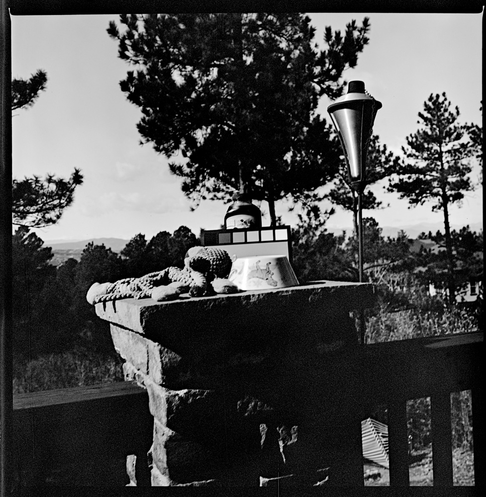

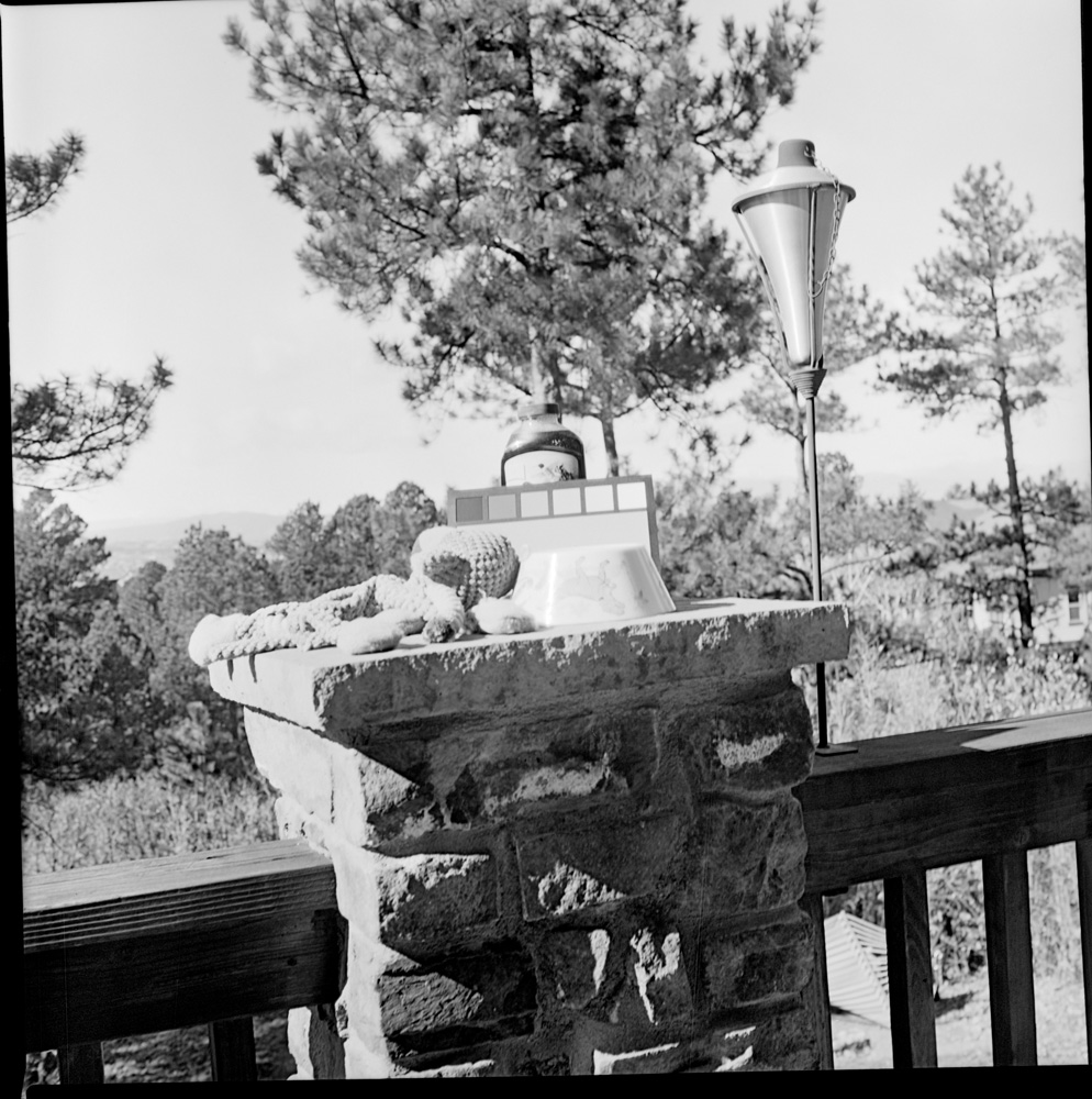

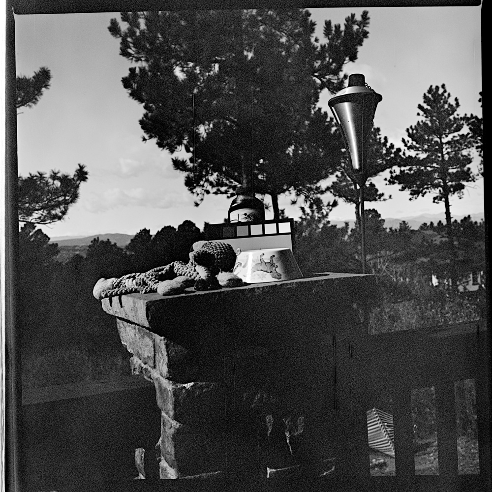

anyway, I decided to try nearly by-the-book development with Pyro PMK with brackets extending from 0.8 to 200 ISO, as well as some extreme over exposure tests that are 4-15 stops over exposed from 0.8. The results definitely carry more shadow speed, but also a lot more contrast and tendency to blow highlights. I did 1+2+100 dilution, 500ml of developer, agitation first 15s, 2x agitation every 1 min after, and 8min total time. Water stop bath and TF-4 fixer. The results still had a lot of base fog, almost as much as 1+1+100 at 10 minutes. The worst part though is the fog is not uniform. It tends to be thicker on the outer edges of the film as well as on the edges of highlights, making anything that has blocked shadows near impossible to print as well as giving a ton of grain in the shadows.
Here are the brackets: 0.8, 1.5, 3, 6, 12, 25, 50, 100, 200. Each one scanned using auto exposure on my DSLR and basically edited in photoshop to try to make them look as good as possible
_0000001.jpg _0000002.jpg _0000003.jpg _0000004.jpg _0000005.jpg _0000006.jpg _0000007.jpg _0000008.jpg _0000009.jpg
Update: fog is due to taking too long to roll film under safelight. Anyone want 10 rolls of "fun" film?
You loaded film under safelight?
Orthochromatic film should be able to be handled under a red safelight, but it has to be very dim, not the normal Kodak #1, but the #2 dark red.
@OP: Good that you found the source of your fog. Now you can get down to really getting to know how your developers work. A safelight test would seem to be in order. Do make sure you've got the right safelight filter.
