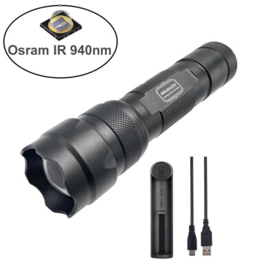

I have a 940 nm IR flashlight I use, pointed up at the ceiling to avoid shining a beam directly on the film. The flashlight is rechargeable, rather inexpensive and does a good job of illuminating the work area with indirect IR light. The rechargeable part is particularly nice, as it is easy to forget the flashlight is even on, unless you touch it. It does get warm, but not blazing hot...
Has worked fine for X-Ray and Arista EDU 100 film with no fogging.

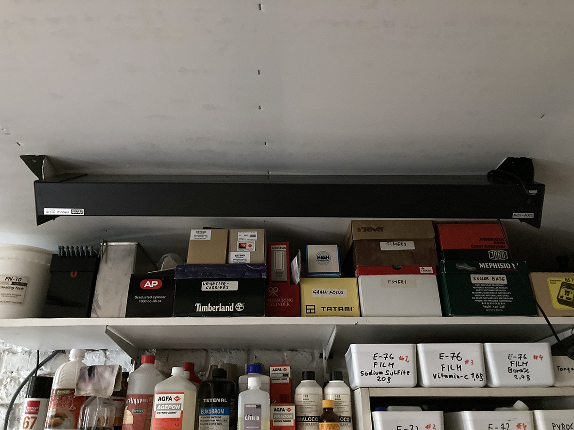

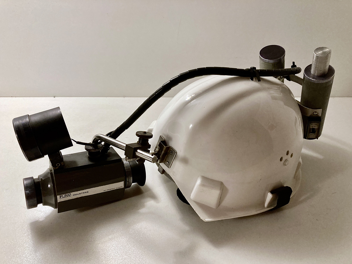

This one is safe (attachment), the IR lamp is on top of the viewer.
Kodak had a perfectly safe filter for their Beehive Darkroom Lights (I must still have a spare laying somewhere).
Made in the USA by FJW Industries

So, I have ordered couple of 850nm floodlights from Amazon and 940nm torch. Although if I directly look at 850nm floodlights I can see the red glow but if I tilt them towards the ceiling, red glow is not visible plus the whole darkroom is IR illuminated. (It is well enough that I dont need NVS IR turned on, so can keep it at IR0)
With 940nm torch, obviously there is no red glow so I will keep it close to my enlarger where I might need a bit more illumination.
Thanks all for your help and suggestions.

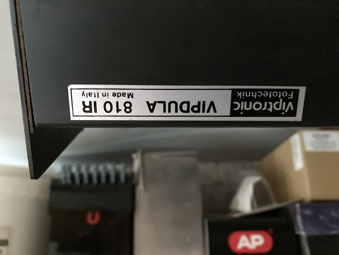

This is the LED 'beam' I have, it's perfectly safe for E-6, C-41 and B&W emulsions, I have used, and tested, it for over 20 years...
I don't know the light frequency but I don't care, I simply asked the (Italian) supplier for an absolutely safe system and this is what he provided.
