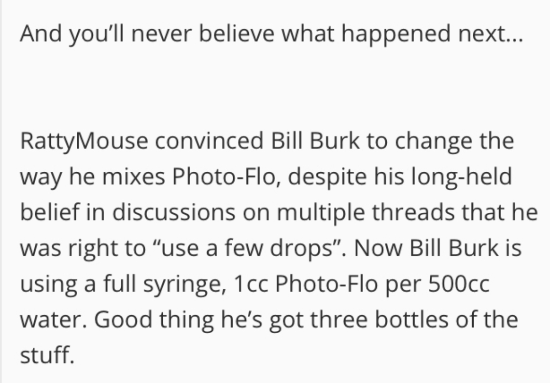

Bill, in case your sarcasm is aimed at me (because I mentioned 0.5 in 500ml in post #34), I have to point out that I use the now-discontinued Mirasol rather than Photoflo, and the recommended dose is 1:400. But anyway, I do what works for me, and so should you. The point under discussion above was how do you measure small amounts, if you want a more precise measure than ‘a few drops’.
Not personally directed, and not sarcasm really. Just matter of fact the conversation with RattyMouse really changed my flow.
I used to be “a couple drops are fine” but then tested for sheeting.
And complete sheeting occurs around 1:500 for Photo-Flo 200 using bottled water. I assume 1:200 gives more room for error, or works with a wider range of water quality.
But sheeting.
That’s what I want. Because it carries away dust.
Sorry, Bill, I misread your post then. I thought you were parodying the discussion as a children’s tale, because I didn’t remember that there was previously a forum member called RattyMouse. Were you referring to this old thread?
No comment :smile:
