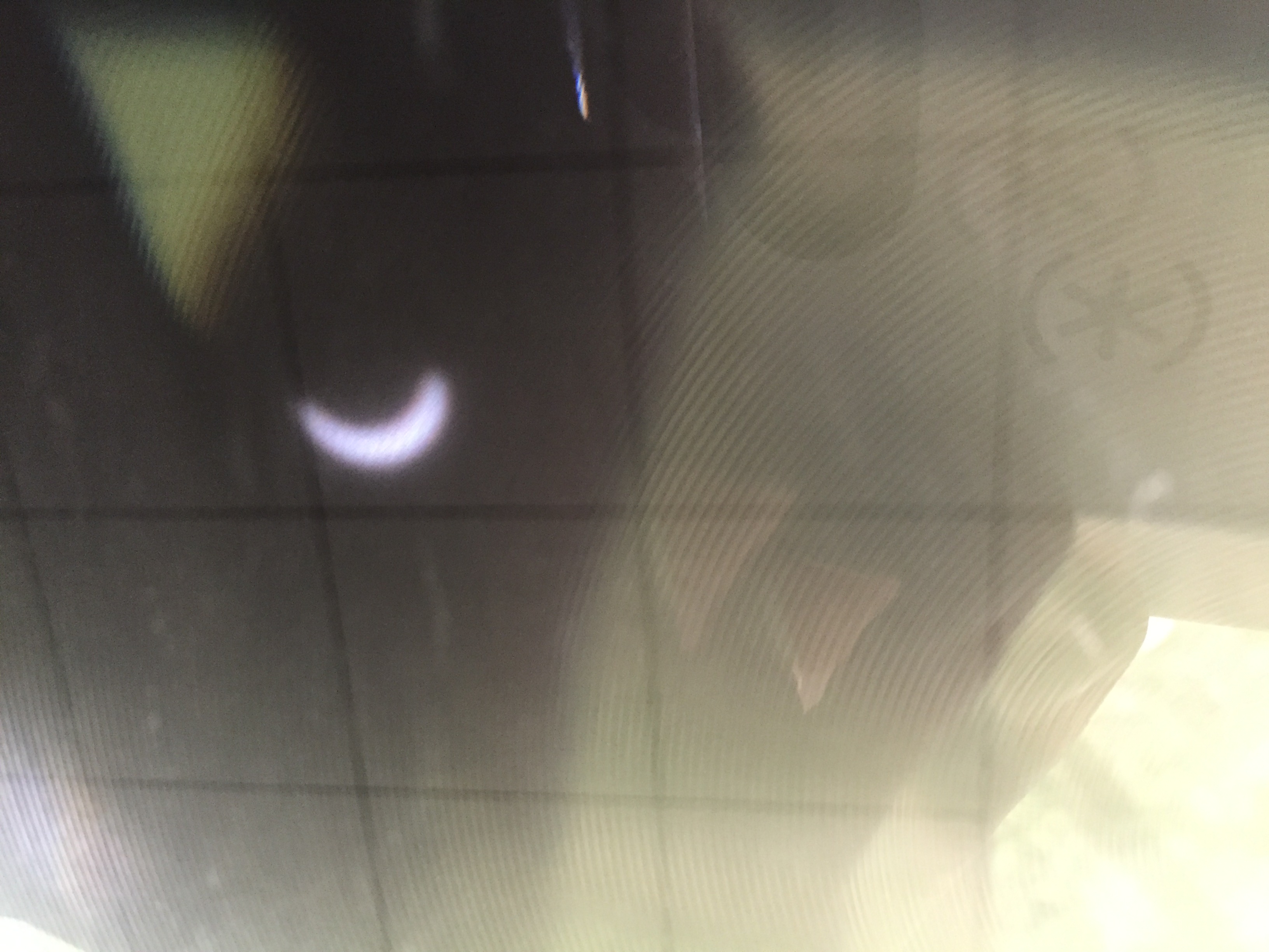

Last partial solar eclipse I used a cereal box viewer with a pinhole that projects to the bottom of the box. You look in the box to see the image, so you are actually looking 180 degrees from the sun.
I was also using a pinhole on the camera, cranked out to about 600mm focal length.
The ground glass view was pretty dim. You needed a dark cloth to see it well.
As you can see it was overcase, but a circle opened in the clouds long enough to make an exposure.

Yes, it will be bigger than the pinhole projected image in a cereal box.
The grid on my ground glass above is 15mm and the focal length for that projected image was about 600mm.
