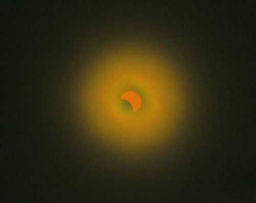

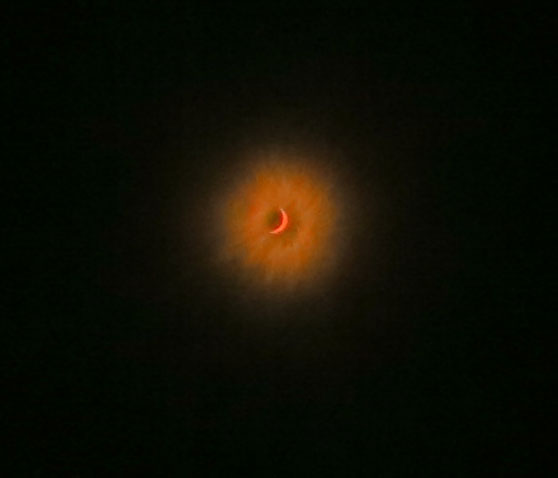

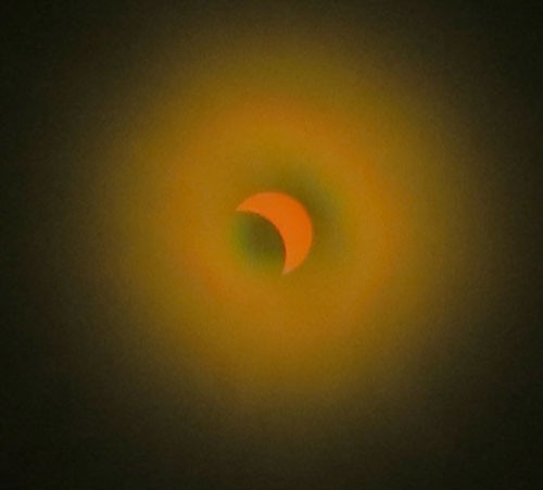

I used a sheet of FP4+ film mounted in a cardboard frame and it came out just right. I tried with 2 layers, but couldn't see anything. One layer worked well, and shooting my pocket digital camera through the single layer film, good exposure of the eclipse was equivalent to 1/125, f8, ISO 100 1.jpg 2.jpg 3.jpg

I used a sheet of FP4+ film mounted in a cardboard frame and it came out just right. I tried with 2 layers, but couldn't see anything. One layer worked well, and shooting my pocket digital camera through the single layer film, good exposure of the eclipse was equivalent to 1/125, f8, ISO 100View attachment 185442 View attachment 185443 View attachment 185444
Those are some unique looking shots.
