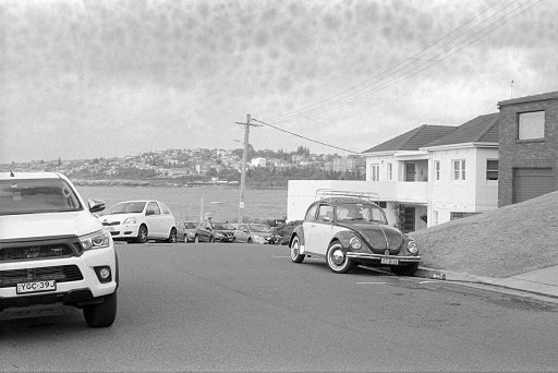

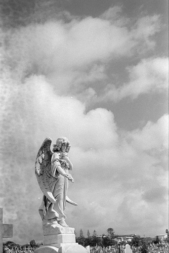

I made it to somewhere between 50 and 100 rolls across 6 months using a 2.5 litre tub of replenished XTOL (from the knowledge gained on this thread.)
Then I found my replenished XTOL getting quite foamy on top. I developed a roll of 35mm, I only used 300ml (enough but I could have used more of course)
The roll came out with an obvious development effect from bubbles - right across the top of the whole roll- something I've never experienced before - very clearly from the foam that formed during inversion development.
Is the foam something normal - or maybe contaminated developer?
It made me think of 'hot break' from my days making wort/brewing beer.
Below is an example image from the roll. I've had to leave the replenished XTOL for now, this roll wasn't important but... just burning through stock mixed 1:1 until I decide on my next move.

Are you sure those aren't alien clouds? Just joking of course. My batch is going on 3yrs old and has never had so much as a bubble. You aren't using any photo Flo in a pre-rinse by any chance? JohnW
Thanks. Rarely seen 'Bubbular clouds' did cross my mind but the portrait shots gave the game up - the froth coming out of the dev tank was another hint in retrospect.
I think it must have been cross-contamination from Photo-Flo then. Probably a poorly cleaned tank. I'll have to up my cleaning game and start my replenishment again too.

Also use one of the benefits with replenished Xtol and increase the volume of developer per film. In this way the foam on top of the developer will have a better chance to stay away from the film and you need not add any more replenisher.

I really don't know what to tell you. I do know that I always pour my used Xtol developer into a beaker and leave until I'm completely done and my roll is hanging. when I pour the developer into the beaker there are a few instant bubble but are gone in two seconds. Your foaming/bubbles sound much different. You might be right about the cross-contamination. JohnW

I would retire [dump] that XTOL batch, and start a new replenished XTOL if I had bubbles like that and especially if the bubbles were messing up the development.
I did tip that batch. No value in risking further problems, I’ll just start over. I’ll do my PhotoFlo in a separate container in future, not the inversion tank and with film off the reel to keep developing and rinse agent fully separated.
There was quite a bit of silvery sludge in the replenished XTOL too. I might consider decanting it every 15 rolls, i can’t imagine it was contributing anything positive to my negatives.
And thanks Karl, I’ll always overfill a little now, may as well.
I’ll also have to add a new mnemonic to my ‘if it’s brown, tip it down’ lol.
If it’s foamy, don’t use it homey?

Going back to Post #129 above. I did tip that batch of XTOL. I then cleaned all my equipment.
I also changed my process so that Photo-Flo now never contacts my reels or my Paterson dev tank.
I developed two rolls in my replenished XTOL at the weekend. Huge foam!
When I burped the Paterson tank after 3 minutes, the foam burst out like a shaken bottle of beer.
When I finished development and emptied the tank, there was a 1/2" head of foam on there.
The rolls show no signs of 'alien clouds' because I now overfill with developer.
But now I have another foamy bottle of replenished XTOL to tip. Maybe 30 rolls is my guess before it got too bad this time.
My chemistry setup is replenished XTOL, Ifostop then Hypam fixer then wash for 6 minutes.
The Photo-flo doesn't contact any of those things.
I only ever use a tiny amount anyway and the XTOL foam I see is not at all like a detergent foam.
The XTOL foam is not from the Photo-Flo is my conclusion - searching other user experiences seems to match.
It seems like the end for me and XTOL replenishment. A real shame as it was very convenient.
I'm imagining I can't be the only one who experienced the XTOL foam like this.
For now I am defeated and will return to 1 shot use.
Your image artifacts are likely a product of inadequate tank agitation,maybe a product of your water supply. I have used Xtol/R for some years,without your symptoms. Try a "rough bounce" - which means thumping your tank,at least twice,after each inversion cycle. I do this for at least the first 6 repeats. And,with Xtol/R,you have the relief of knowing you are not wasting the developer. Caution : a Rough Bounce involves caution - Paterson tanks are brittle-Jobo not so much. A 2inch drop onto a hard surface will suffice.And using a larger tank will lift the foam level above your film..
I've experienced a variant of the "bubbles on film" problem in the past which in my case was traceable to wetting agent cross contamination, so I now always pull the film off the reel and see-saw it through a wetting agent solution in a separate container.
