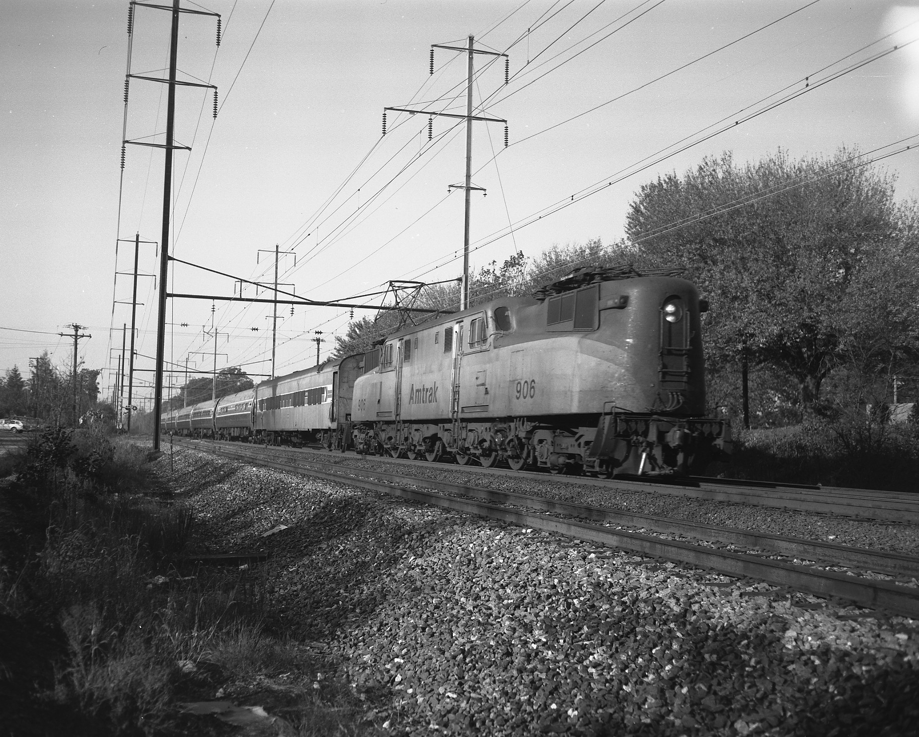

The 4x5 Speed Graphic is my favorite camera for shooting black & white. It allows me to continue using my favorite film, Tri-X 320 (now discontinued in rollfilm sizes). Typical exposure is 1/250 @ f11 with yellow filter. Prints are grainless with beautiful tones. The Speed Graphic has a vertically traveling focal plane shutter which, when shooting a fast moving object, will make the object lean in the direction of travel -- the faster the object, the more the lean. in the attached 1978 photo, the train was traveling approx. 80 mph and the image shows it!
Gary
